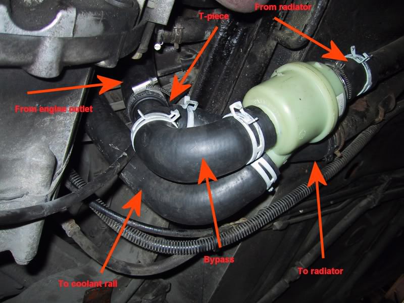

and a image of a prt
Replied by David Aiketgate on topic overheating TF
Posted 9 years 9 months ago #172150
COMMANDER wrote: I'm afraid I cannot help, but just as a matter of interest so as not to confuse others, or is it me who is confused, the cooling circuit diagram posted by mgbluestreak on page two shows the hot water entering the rad via the bottom hose and the cooled water leaving at the top. This I am sure is contrary to what I have believed for years (55 ish). Am I really going senile or am I missing something ???
Fitting the PRT system effectively reversed the flow through the radiator. Something I noticed when I did the retrofit of the PRT. It also reverses the flow through the engine too. :yesnod:
The following user(s) said Thank You: mgtfbluestreak, COMMANDER

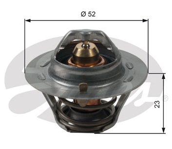

These replacement thermostats, where did they come from?...............did you get them from some who knows what a MG actually is, or are they something the spotty 12yo oik at Halfords handed you?
Not all thermostats work the same, whilst I've not had the pleasure of having to deal with the cooling system of my F yet, I do know that on some cars such as the TR7 the correct pattern thermostat is important (it's a double valve type)

one was supplied by the mobile mechanics & the others I've sourced myself from a small motor factors I've used for years, the latest is from a rover 200 as it's an 82 degree version rather than 88.
Really clutching at straws here & I can't see it making much difference, does anyone know which way round the pipes connect onto the matrix? looking at mine the flow goes into the left hand side & the return comes out the right, just want to make sure this is right.
