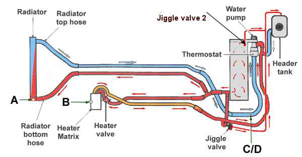

Cobber wrote: I wasn't referring to the radiator, I was referring to the heater matrix (cabin heater)
If they're connected the wrong way around, it could cause an air pocket that can't be bled off properly.
Looking at a diagram in the manual, the heater hoses cross over one another on their way to and from the engine, so it would be easy for someone to get them arse about.
Aaah never thought of that, is there anyway of checking?
by Daz
Replied by Cobber on topic overheating TF
Posted 9 years 9 months ago #171973
You could try switching them about, it would need to be at the heater end, I duuno how easy it will be to get access to, as I've not had any need to work in that area.
Maybe someone here will be able to enlighten you on how to go about it.
The water should flow from the engine to the "T" that that on one leg heads to the radiator and the leg that we're interested heads to the heater flow control valve the into the heater. It should then flow back towards the engine.
I know the Triumph TR7 (with air con) suffers from air getting trapped in the heater matrix when the hoses are arse about..

Daz, did you check the jiggle valve in the inlet manifold?
After checking the cooling system on my TF again and again (and replacing part after part) I found this valve being blocked
and causing the overheating.

The jiggle valve from the inlet manifold has been removed at some point in the past, from what I've read this is ok due to the positive pressure & shouldn't cause any problems. I'm happy to be corrected though :-)
Cobber,
I've checked the heatet hoses & to be honest with the shape of the hoses it'd be a bit difficult to get them the wrong way round at the engine side, the heater end looks ok too as they're shaped to fit.

Just a thought; you say the TF is a 2003 pre PRT? If a PRT and standard engine block return thermostat were fitted you would get the same symptoms as the heater circuit by-passes the standard thermostat back to the block allowing coolant flow; albeit a tad restricted, when the heater valve is turned off flow will stop; no matter what temperature the engine gets to.
Have a good look at the coolant circuit and check for a retro fitted PRT (an alternative position for a retro fit PRT is at the front subframe)
Brian.
