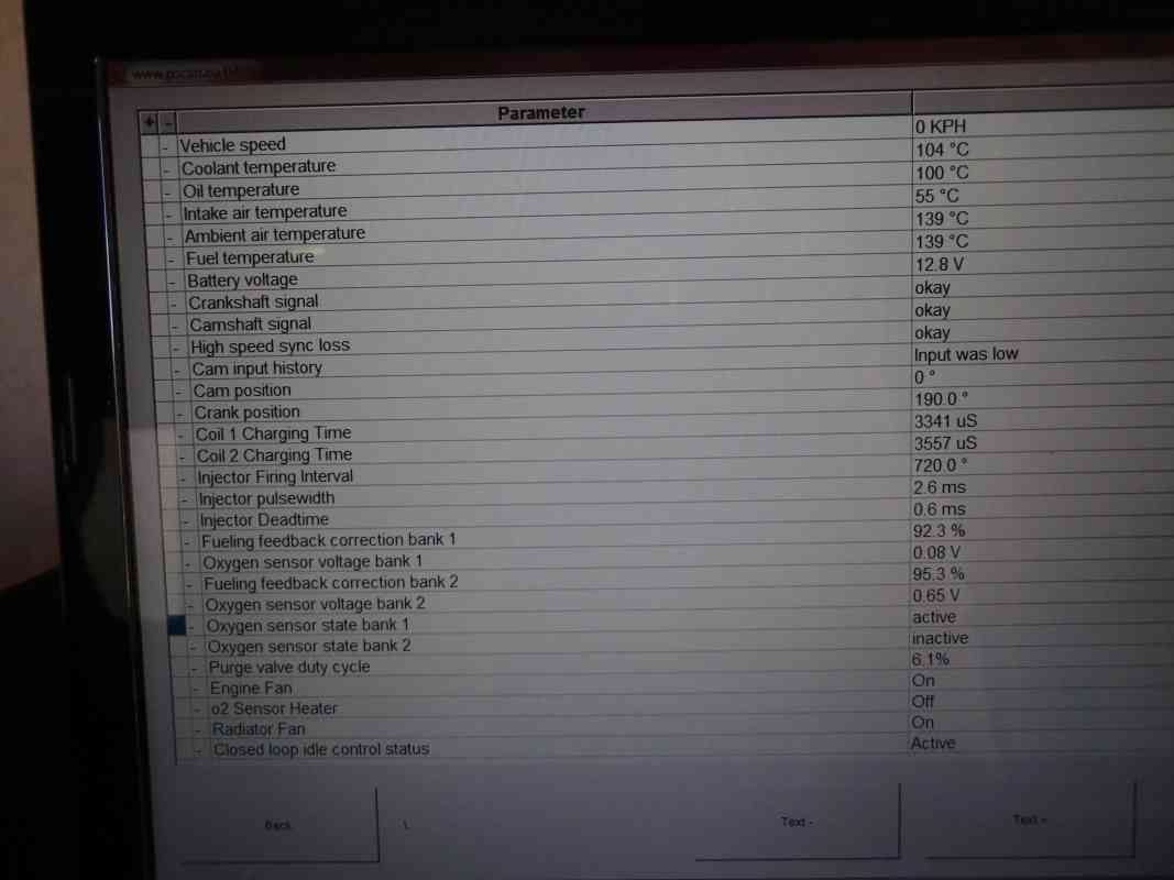

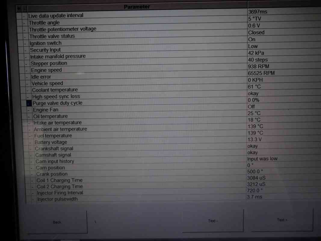

Replied by sworkscooper on topic Pscan
Posted 11 years 5 days ago #160704
Hi , hope this is what you want. I did take a few shots of the logged fault codes but they were out of focus. Logged code was multiple miss fires but as the engine is running fine I think this must be historic before my ownership. It did clear the error which is good. John

Replied by adamelphick on topic Pscan
Posted 11 years 5 days ago #160710
You should be getting a lot more readings than that!

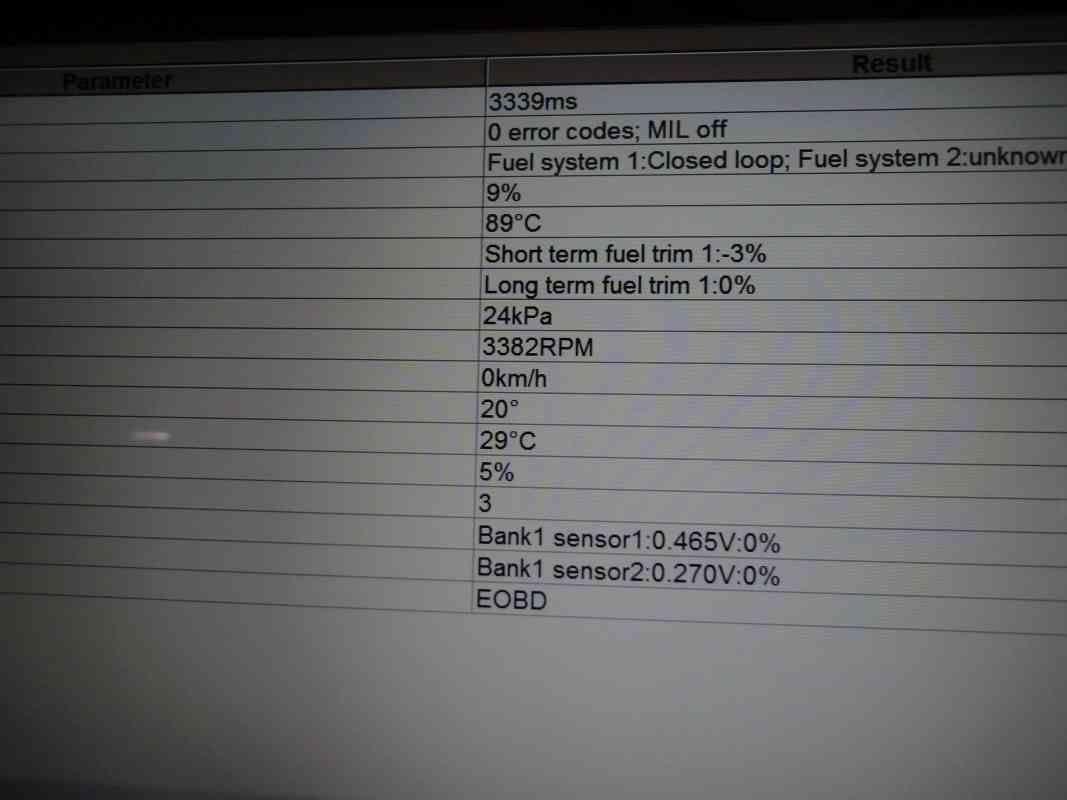

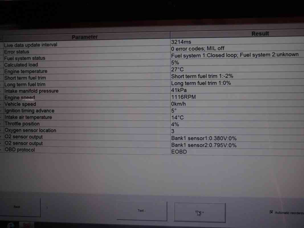

Posted 11 years 5 days ago #160711
These were from the TF and was just the same as when hooked up to the ZR . However when I coupled to the Classic Mini there were quite a few more readings on the screen . Am I doing something wrong ? John
Posted 11 years 5 days ago #160715
sworkscooper wrote: These were from the TF and was just the same as when hooked up to the ZR . However when I coupled to the Classic Mini there were quite a few more readings on the screen . Am I doing something wrong ? John
Yep I think you're connecting in OBD mode... the other connection types give more information as gthey are ECU model specific. Connect yours as MEMS3.. you'll be amazed what you can check then!

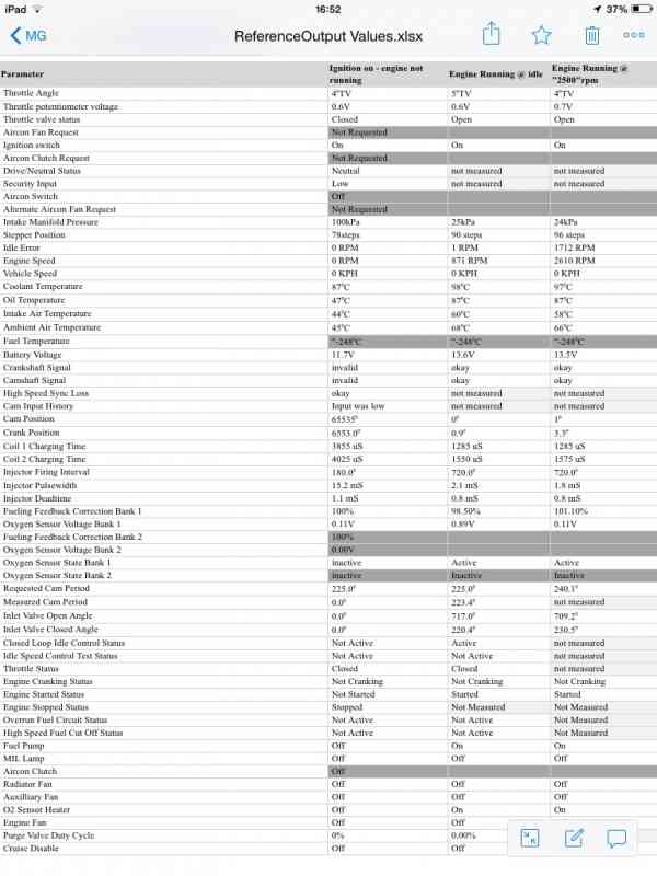

Replied by cairnsys on topic Pscan
Posted 11 years 4 days ago #160734
I started putting this together a little while ago but haven't done much recently. It's for a mk1 F VVC.
This is a screenshot but I have it as an Excel spreadsheet if anyone wants it to add the data for their own variant as a separate sheet, if someone can tell me how to upload it

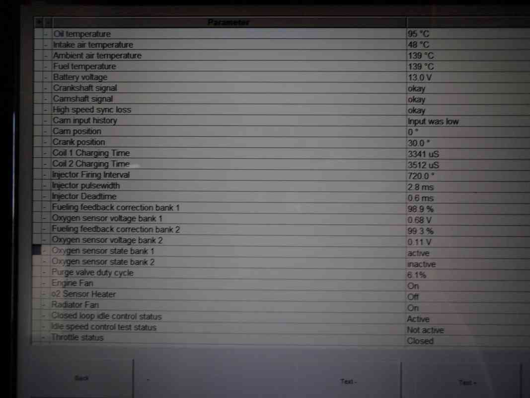

Posted 11 years 13 hours ago #160794
Hi . Yes it was me not knowing my A... from my Elbow. These are more like the readings I should have sent the first time . :clap:
Posted 10 years 11 months ago #160805
Cool - let's start building a database of readings and then we can kind of work out whats best for what engine maybe?
