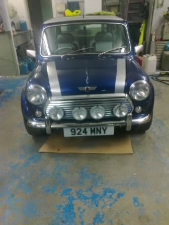

Hello David. As a recent new member and owner of a TF , is there any way of me being able to buy one of these code readers or have I missed the boat so to speak ? I would find this a very useful bit of kit as my wife and I also own a 2000 MDY Classic Mini Cooper which after reading about this would also be able to access the earlier ECU. Regards John

Hi guys . Thanks for the information on this and I will be certain to place an order for one. It will be useful for all 3 of our cars especially the Classic Mini 's' works that we have as not many people have a reasonably priced code reader that will interrogate the ECU that's on it.
