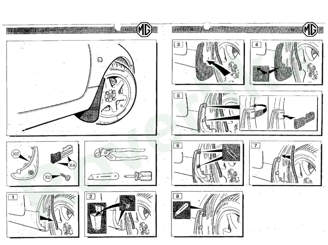

MG F/TF Mudflaps Fitting Instructions
MG F/TF Mudflaps Fitting Instructions was created by Roverlike
Posted 2 months 1 week ago #223188
MG F Mudflaps Fitting Instructions
FRONT
REAR
Last Edit:2 months 1 week ago by Roverlike
Last edit: 2 months 1 week ago by Roverlike.

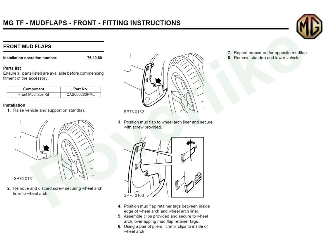

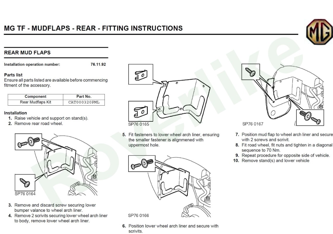

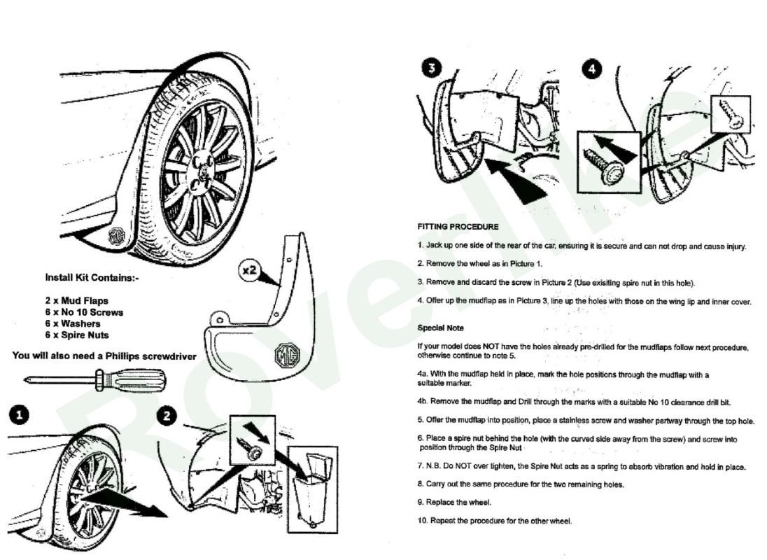

Replied by Roverlike on topic MG F/TF Mudflaps Fitting Instructions
Posted 2 months 1 week ago #223189
MG TF Mudflaps Fitting Instructions
The following user(s) said Thank You: R40MGF, D4KGP, argentas
Replied by Airportable on topic MG F/TF Mudflaps Fitting Instructions
Posted 2 months 1 week ago #223194
I fitted a new set to the f the other day & as such I’m familiar with the process. I am usually a little dismissive of the sort of fittings supplied with this type of item, however these were very effective & easily fitted.
I doubt they will come off without a fight.
Thank you for putting these items up, granted I’ll not need them again, but others will.
