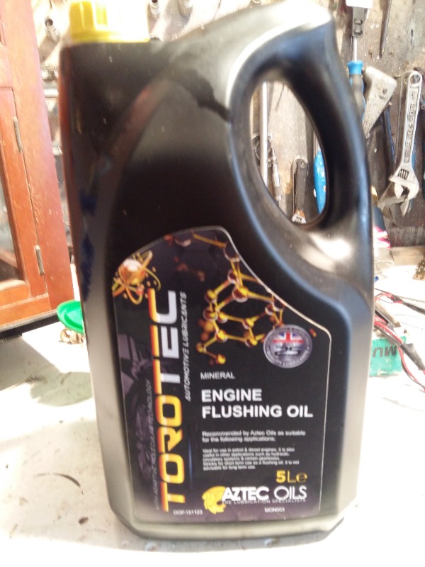

As I said I removed the old black oil after getting the engine warm and refilled with 5 ltr of flushing oil I then ran the engine for about 15 minutes ,giving the throttle the odd blip ,however after 3 to 4 minutes the engine ran better you could hardly hear the tappet .After the 15 minutes I drained the flushing oil and refilled with fresh good quality oil ,I al fitted a new oil filter which was a real problem ,it just wouldn`t undo so I used mu usual method of driving a screwdriver right through the old filter .I had to do this three times to get it to unscrew Now the engine is a dream I wouldn`t have thought it would work so quickly ,but with so many members saying how to do it I had faith !!! CAN SOMEONE TELL ME IF YOU VAN INCLUDE A VIDEO ON YOR POST .I`ve tried twice but only the photo appears Len
by digcot65
Well done for completing the flushing job. Would it be possible for you to tell me what brand of flushing oil you used, as I have to undertake the same job soon. Thanks Glyn.
Hello it was as shown in
photo TORTEC off Ebay I bought the new oil off Amazon which was Mannol 10W -40 Len
by digcot65
