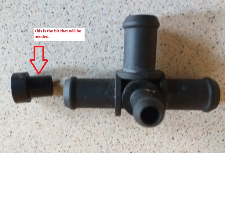

This is the bit that would be needed, i.e. the bit that inserts into the 4 way connector.
Any ideas please (other than find a machine shop to turn one up).

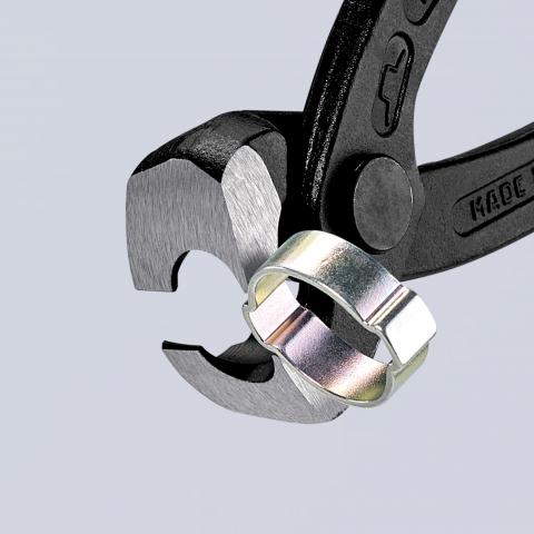

I have over the years supplied many different types of hoseclamps. The Jubilee in its day was revolutionary, but its very design means it never tightens in a concentric manner. There is always a little bit of tube that is not clamped sufficiently. Cobber is quite right to identify the "super clamp" as a better alternative.
In industrial applications where the clamps do not have to be removed regularly, eared clamps are used, the type with a double ear that is permanently crimped with a pair of wide jawed snips or pliers. They of course can only be removed with a junior hacksaw, so only ideal where access is not an issue and regular removal is not required.
Yes those eared clamp are what we use in industry on the operators pneumatic retracting air hose reels, because you cant tell the knuckle heads not to pull the hose out by only gripping the air gun, thereby putting all the load on the hose joint, instead of gripping the hose to draw it out of the reel and drag it about! They never listen as they are the fonts of all knowledge and wisdom, which of course explains why they are paid much less than us!
We find these types of clamp hold well due to their permanent crimped nature.
There are both double and "van Gough" single eared versions
you need special crimping pliers to crimp them and these come in single jawed
and double jawed with side jaws for space restriced applications
There are also pneumatic are crimping tools available.
To remove these clamps we either grab them by the ear with a set of wire cutters and twist to open them up or cut the ear through with a small set of bolt cutter type pliers at the eye of the crimp, I've also seen angle griners used to remove the but this usually damages the hose!

I wonder if a short length of copper pipe of the pre requisite bore and od would suffice ?
it would bottom out perhaps (as it is slid in) on the inner wall of the cross piece, or a transition fit, tapped in with a toffee hammer ?
