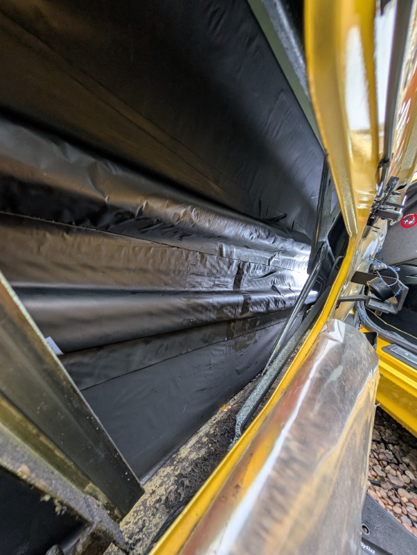

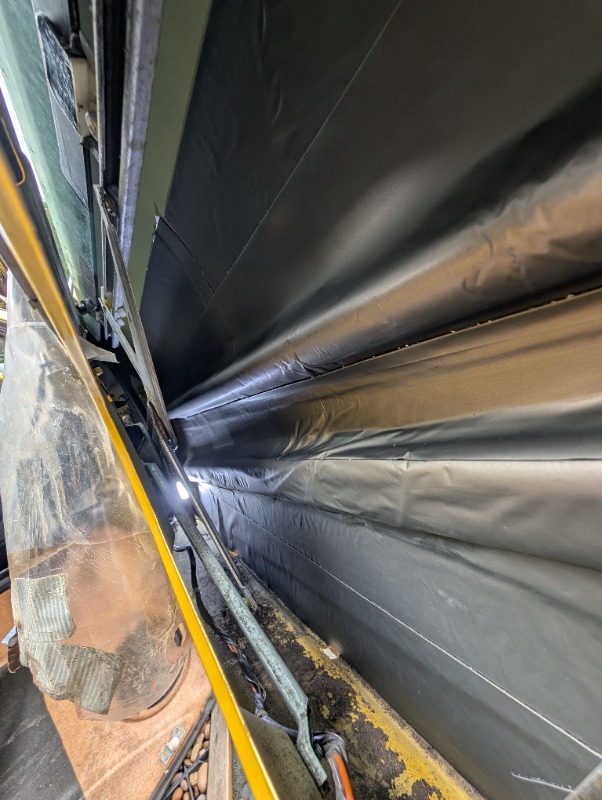

So today i was removing my door cards in order to swap out the "technical" trim pieces for some i'd sprayed yellow (no not Sunspot but as its the interior i don't think it's as important with there being no direct comparison, i'm sure others will disagree and they're welcome to send me a few litres of Sunspot to solve the problem) while i was in there i thought "let's get this sound deadening done" so that's whta i did and i thought i'd show my work here so you can tell me if i did it right or not.
I wasn't able to go between the crash bars and the outer skin as the adhesive/foam used by the factory went all the way down the length of the bars but i did manage to get everything pretty much covered. Haven't taken the car out yet so can't say anything about any changes to driving rattles but i didn't notice a great deal of difference in terms of the noise of closing the door so not sure if i've done it wrong? i even listened for a difference between the two doors after finishing the first one. At the very least though i'd imagine its good for the general insulation of the car and hopefully i'll notice more of a difference on the road. Plenty left over so might do the bonnet and boot next.

What you have done looks fine and I couldn't get mine between the bar and the doorskin either so I just wrapped it.
There isn't a significant difference just closing the doors but on the road it stops a lot of resonance. The panels don't zing anymore.
You saw my post on it so you can see how far I took it. The floorpan and behind the seats make a difference. It's hard to believe there is nothing on the floorpan from factory.
I have yet to do the boot lid and the rear panels in the boot but I soon will.
We were coming back up the M6 from Keswick yesterday and my wifes car shed a pad which knackered the disc so today I went in to Aberdeen to ECP for discs and pads. I haven't been out in the TF for a few weeks so I decided to go in that and in all honesty I was surprised how quiet it now was. It really felt quite refined and "solid" on the road. I was smiling the whole way!
It is well worth the effort and keeping a roll handy in case you suddenly do a job that exposes a bare panel is a good idea.
Good luck.
