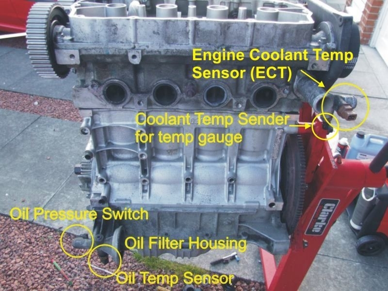

For info:-
It's the top coolant temp sensor being discussed here.
Incidentally any cheap obd II reader will show up a dodgy sensor.

Thanks! That helps me familiarise with the engine.
