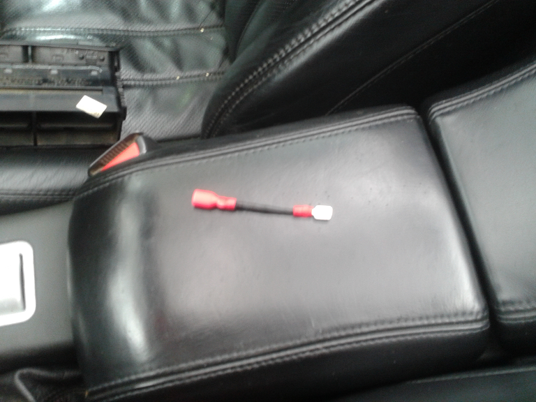

Wanting to get a more accurate gauge rather than just reduce the reading, I bought a selection from 10 to 50 ohm from Maplins and prepared to experiment. They only stock 0.6w but that difference is not important.
I visited my friendly MOT garage and established that when the gauge read 130 the oil was actually nearer 95.
So then it was a question of introducing the various resistors until the reading was correct. In the end it was 45ohms that did the job.
Also I reasoned that it was substantially easier to introduce the resistors at the gauge end rather than the quoted above position. So I made up a small adapter to go between the plug and the gauge. I soldered a male and female spade connector to each end of the resistor covered it with shrink tube and Robert's your father's brother.
Then it's just a case of popping out the centre vent and inserting my adapter into the line.
:broon: :woo2:
