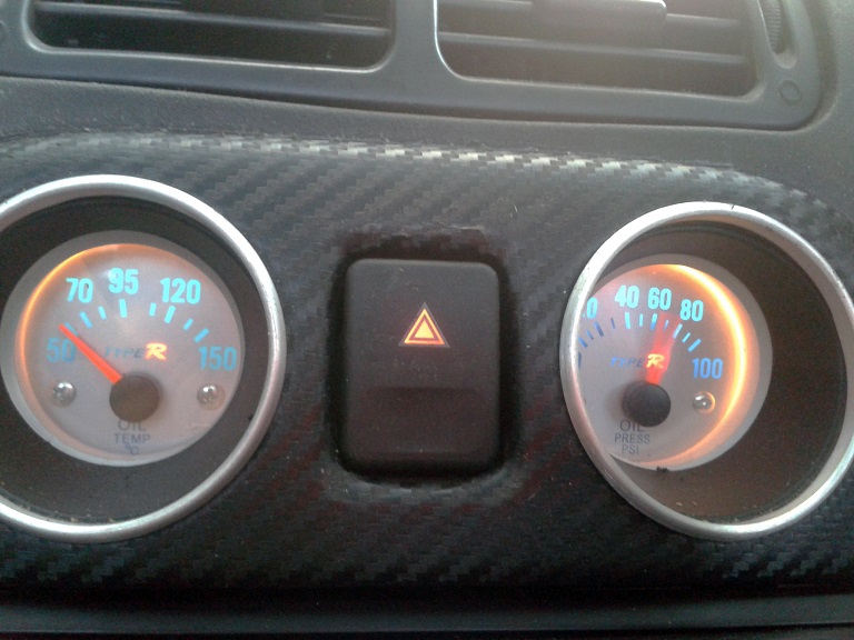

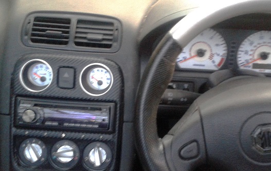

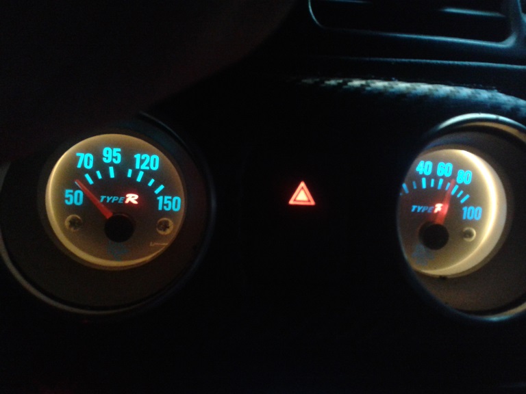

Took out the clock and original oil temp gauge and fitted this pair that nicely match the plasma dials.
Only hitch is the sensors are both 1/8 NPT and don't fit. The originals are supposed to be 1/8 NPT, but are actually a larger thread.:shrug:

Looks nice! :broon:
Where are you getting the oil pressure signal from?

Replied by David Aiketgate on topic Matching oil temp and pressure gauges.
Posted 11 years 10 months ago #149443
PQD44 wrote: Looks nice! :broon:
Connected it to the oem oil pressure switch.:shrug:
The temp gauge is connected to the oem temp sensor too. :broon:
So the oil warning light pressure switch gives an analogue output?
Posted 11 years 10 months ago #149448
John and Sue wrote: Nice. :broon:
Is there a prize for guessing the donor vehicle?
:coat:
Sorry John no prize for you.
Type R is the name of the gauges... :P
edit John, TBH, I have no idea what the pressure switch is outputting but thought I'd try connecting it and seeing what happened. That's until I can get a couple of thread adapters.
