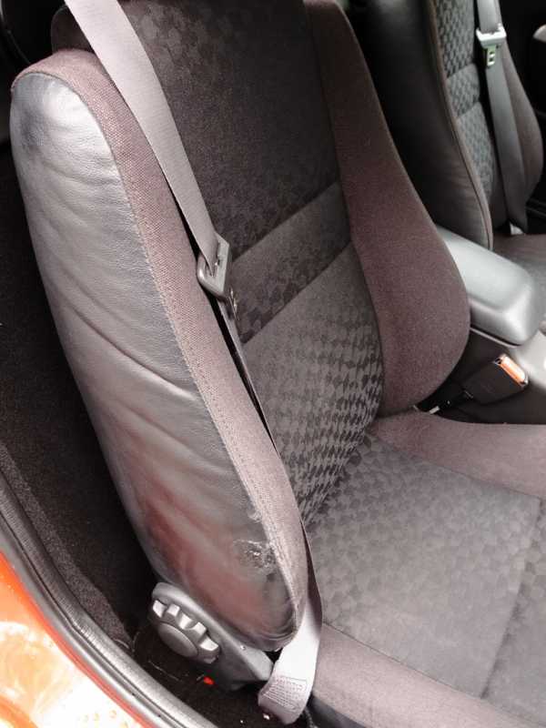

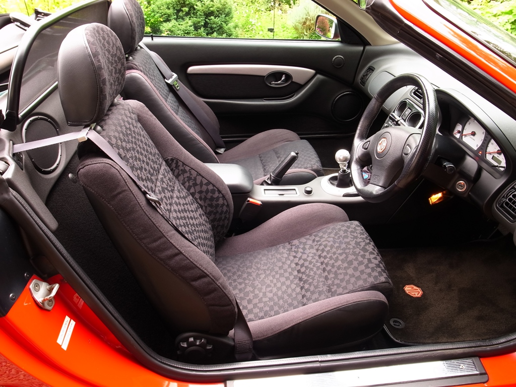

Here is a picture of the fitted cover....there seem to be 3 variations on the Mk2 Mirage cover.....one has cloth & PVC outer bolsters but no Mirage insert in the inner bolster, another does have an insert and then there is my original cover (backrest) which didn't have a Mirage insert in the bolster but had outer bolsters competely covered in PVC. As you can see, my new cover is the one that has a mixture of PVC & cloth on the outer bolster and the Mirage insert...this means I now have a unique driver's seat (I guess) with different designs on the 2 pieces...I actually quite like the result.
