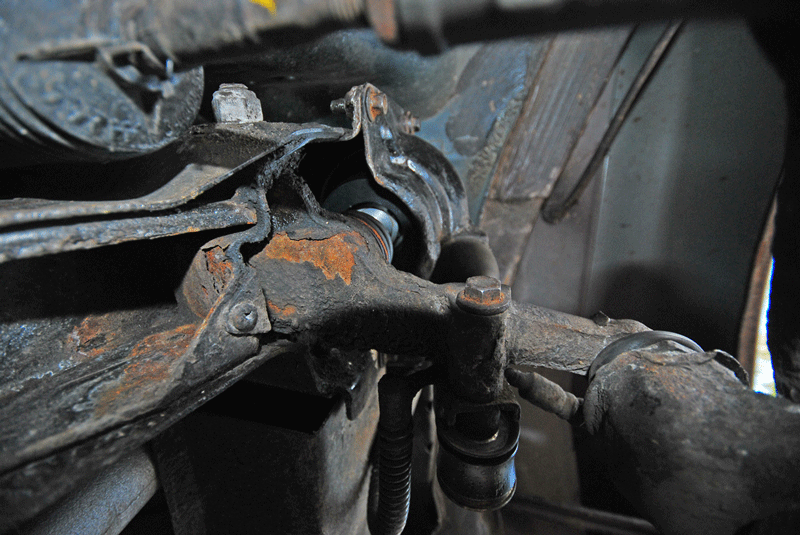

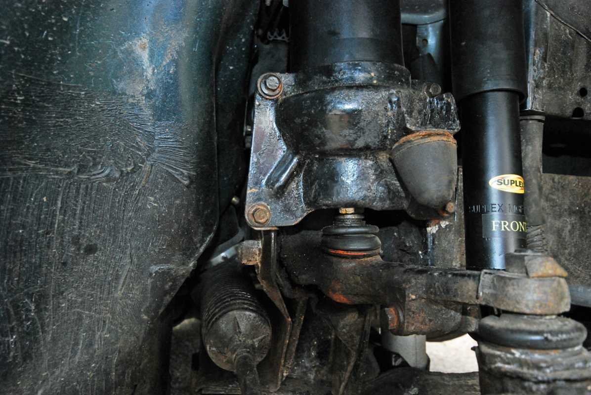

Replied by David Aiketgate on topic Photos
Posted 14 years 6 days ago #58049
Here are some photos.
Wound out to Suplex recommendation before refitting wheel and lowering car to ground
After taking the car's weight
Best photo I could get showing the spring and seat disappearing up into canister
