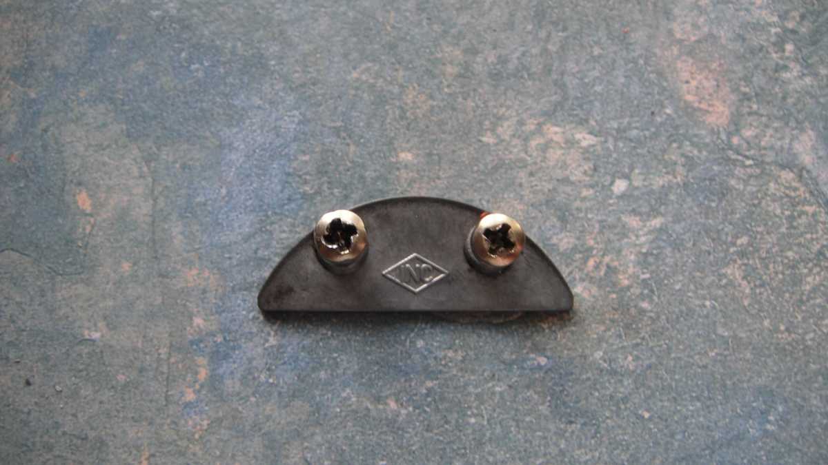

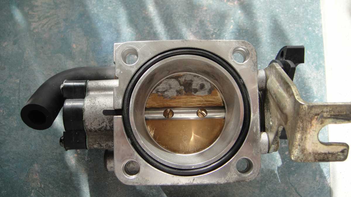

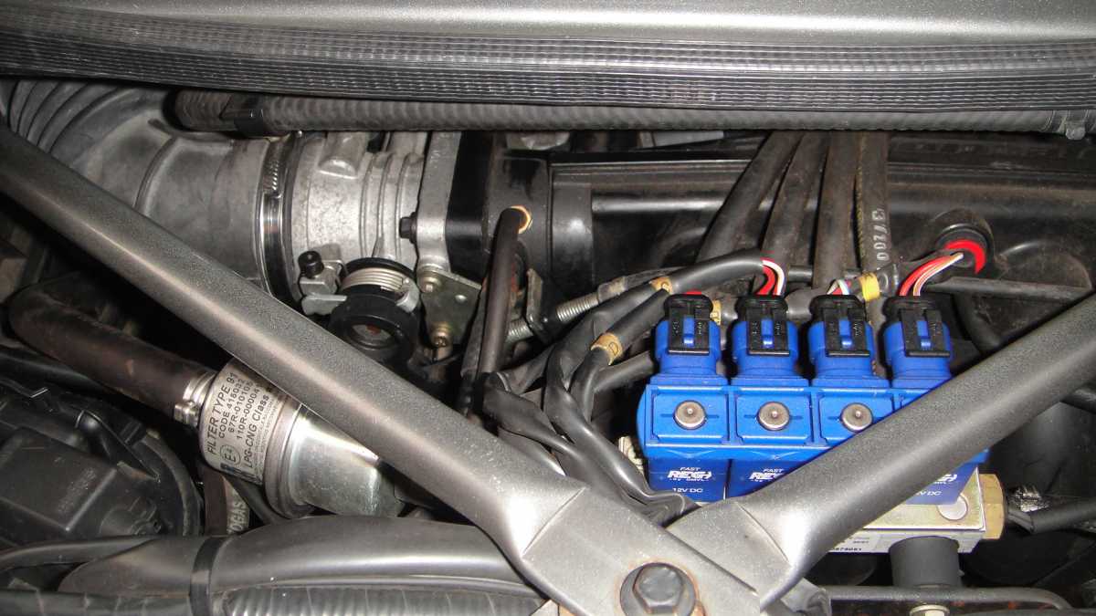

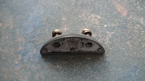

Had a half day today so I also decided to tackle this mod. Took me around 3 hours to do, primarily due to my lpg setup. I have more pipes than most to contend with as the first pic shows. The how to guides are well established on this mod and they have good pics already. So, I just took a couple more for comparison purposes. You can find the original guide here - Throttle body 48mm - Modification guide.

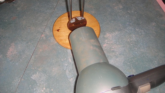

Here's the stuff I used to plug the holes. I dried it with a hair dryer and gave it a rough file down once it had cured for a while.

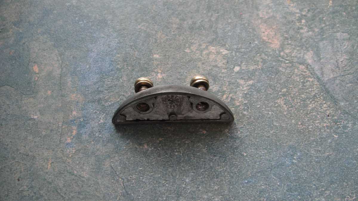

The wedge removed.
Did it work? Yes, seems to be a little more oomph low to mid range torque. Interestingly, I noticed that I'm now sitting at around 2500 revs when doing 70mph instead of the usual 3000 rpm. I didn't expect that. Idle is crisper too. Maybe that's down to it being given a good clean with carb cleaner. I'll report back if anything else develops. But I'm pleased with the initial results. Thanks to PQD44 Paul and Whiz for their respective guides. :broon:
