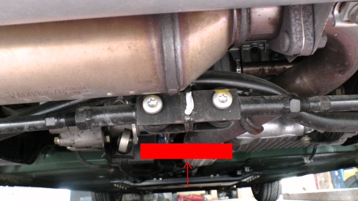

Its a pity the photos of the jacking points early in this thread are no longer available. Does anyone have photos of the front and rear jacking points to save new members guessing ?
The following user(s) said Thank You: RookyMGF
Replied by R40MGF on topic Jacking up your MGF or MGTF - 'How to' guide.
Posted 2 years 9 months ago #204185
Front jacking point
Rear jacking point
Mid jacking point
I'm not very good at this sort of thing but it may help someone.

Which cars have both central jacking points?
cjj’s ‘04 TF does not have the front one, it seems

It is a bit tricky to get far enough underneath to be sure BUT would be OK to jack, with a suitable block under the bottom central arm pivot?  It seems to be strongly braced.
I intend to make a cross beam to also pick up on the lower suspension ball joints so the whole will lift together.  Bad idea?
