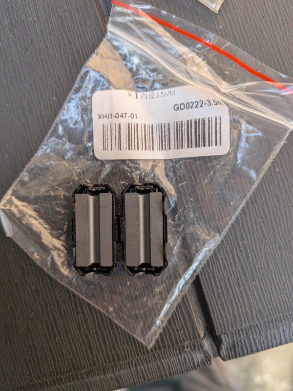

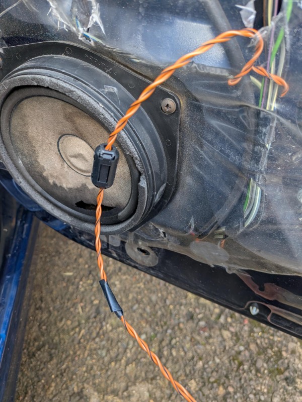

A while ago my car started sending down the drivers side window with the intermittent wipe on.
A common enough fault apparently rectified with a capacitor wired in somewhere.
However.
As I was fitting new speakers I thought I would fit ferrite noise suppressors to both the speakers and also to the window motor cables to see if they would help the window issue too.
My theory is that the motor cables act like an antenna, drawing in spurious electrical noise and setting the motor in motion.
It has been quite a while now and as I use the TF as my main car I have had lots of opportunity to test the intermittent wipe.
So far so good.
The pictures show my shot speaker and also the ferrite clips that simply fold over the cable and snap together.
Hope its of some use.
