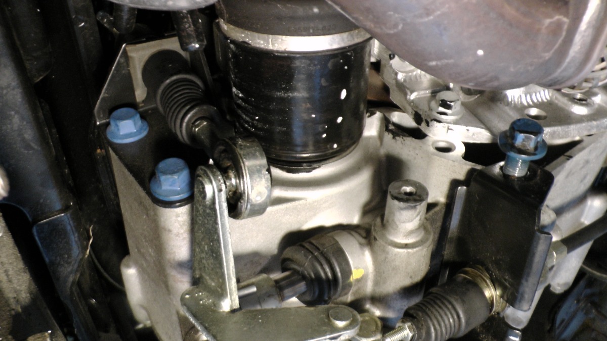

Why are these gear change bracket bolts a pretty blue?  Does that indicate a "lock tight" bolt?

Replied by TA22GT on topic Blue Bolts?
Posted 2 weeks 12 hours ago #224158
Yep.
I think it is medium strength threadlock.

Replied by Airportable on topic Blue Bolts?
Posted 2 weeks 10 hours ago #224161
It might be an indicator of a different thread form. It might be worth looking at Rimmers site to see if they make any comment.
Posted 2 weeks 9 hours ago #224162
Or possibly larger thread, small flange head(?).

M  -  seems standard MM small thread.  No idea why -  its only a basic simple bracket.  I was a bit dubious undoing the bolts   Just in case I was rewarded with a sharp clang from inside the box as they were removed.  So far all is  quiet.  As it happens they did not need removing anyway.  Pull out a locking thingie and the cable can be removed easy (ish).  Now to lubricate and see if it makes any difference.

Wishing to be wiser on the blue bolts & why blue, I looked at the Rimmers website & found their listing showing them as blue.
Odd & thus no wiser !

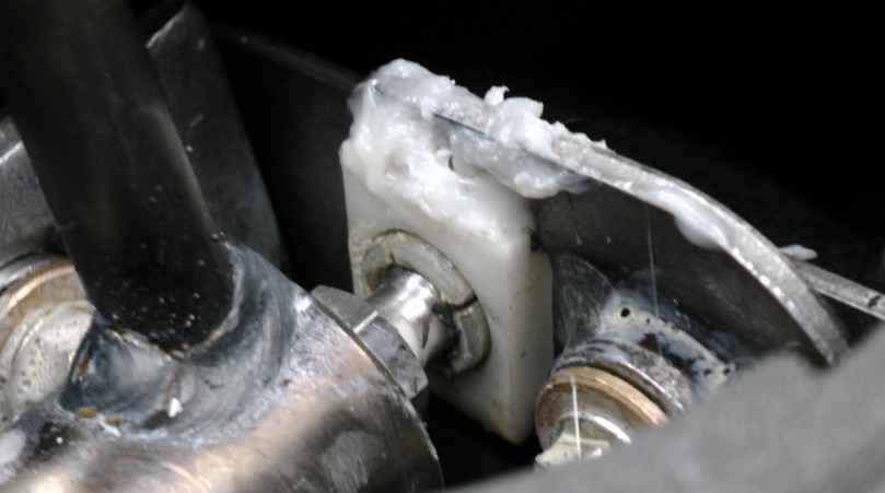

Here's a funny thing -  I had put the bracket back, but only hand tight, and the gear change was locked.   Would not move much in any direction -  oh *******!  What have I done?   Tightened the bolts, both normal and blue, and the gear change worked fine.
I have made a small improvement by lubricating the cables (after a fashion) but most by stopping the nylon bellcrank pivot thingie from moving by embedding the top in epoxy resin.
