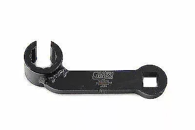

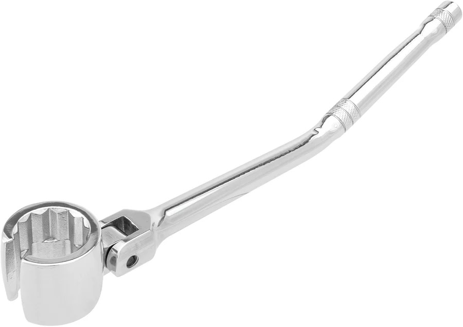

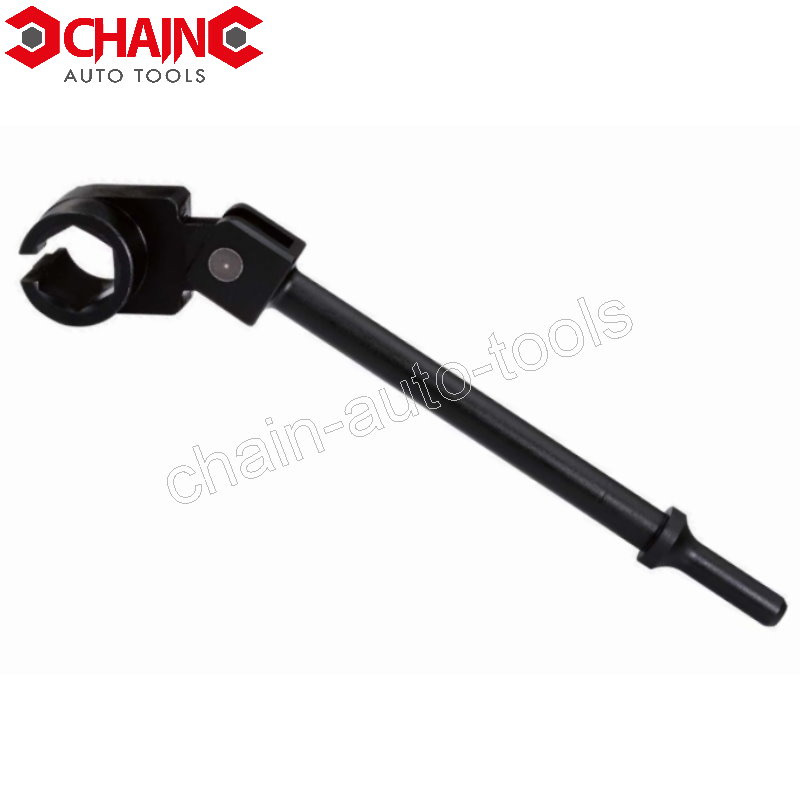

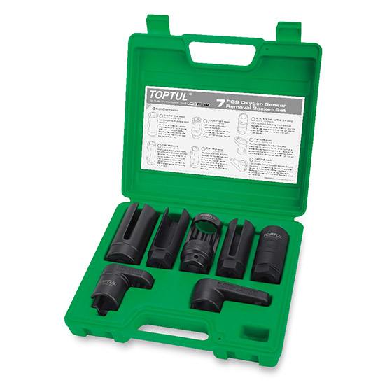

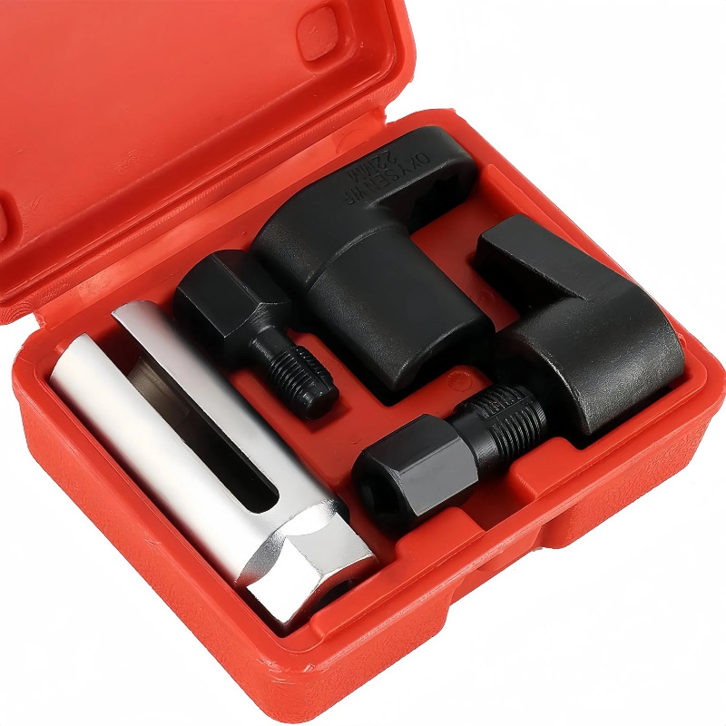

There are dedicated tools to remove O2 sensors which are easily found on the likes of Amazon, ebay and automotive shops for not a lot of $$$, or you may already well have something in your toolbox that will do the job well enough for you, I suggest 1st you have a try with what you have before rushing out and buying something you don't need, Sometimes they will come loose easily, with a sort sharp hammer tap on the tool, but they can often be bloody hard to undo.
A note to the wise: if you feel what ever you're using feels like it may slip and round of the hex head....STOP!......Don't risk rounding the hex off.........You will need to get the proper tool.
The dedicated tools can vary from simple tools to more elaborate ones to get into awkwardly place sensors to whole sets, some with thread chasers to clean up shiity treads the are even ones to be mounted on an Air hammer of seriously stubborn sensors!
Whatever you do ........don't use a bloody shifter (adjustable spanner)

A good tip is if you get the correct socket with the cutaway for the cable put a jubilee clip around it once it is in place.
Stops it opening up.
- Airportable
- Posts: 3672
- Thanks: 912
By making the”wire slot” wider, less damage is done on removing the old & refitting the new. Obviously this would weaken the tool, allowing it to open if excess grunt is applied & this is where TA22’s tip with the jubilee clip comes in.
I made a sleeve which just slipped over the socket, making the assembly very solid.
Having gone to all the effort the bloody sensor came away easily.
by Airportable
- Notanumber
- Posts: 2374
- Thanks: 504
+1 for using the right tool. Lambda sensor removal socket or variation on that search phrase into Ebay will bring them up. They are too expensive and you can always sell it on if you dont expect to be using it more than once. Dont try to use an adjustable. The right tool, a modicum of turning force and it will move.
