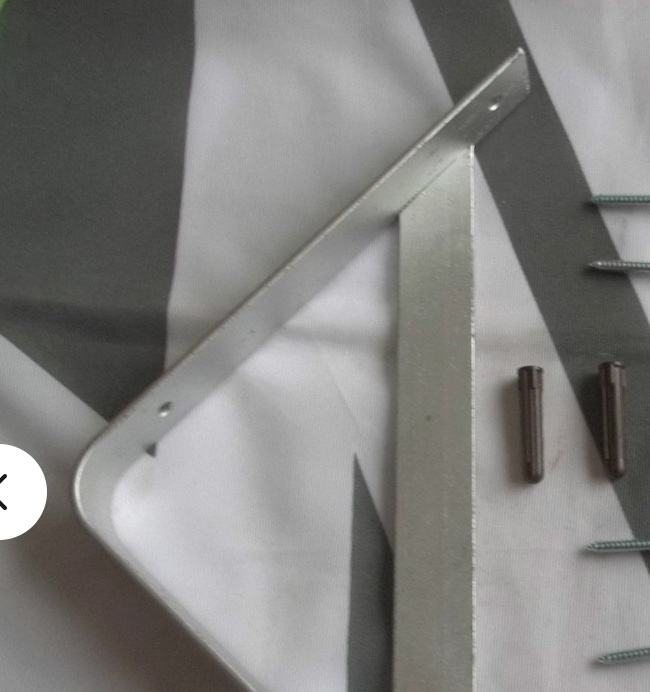

With summer around the corner, I thought I'd go ahead and get some wall brackets to store the hard top on the garage wall (bought from MG Mania LTD on Ebay). Given the hard top is 18-20Kg's and a bit of an awkward shape I just thought I'd see if there was anything to note from anyone who's installed them.
Plan is to ensure all the holes go into brick and not morter, the rawl plugs that came with the bracket look pretty cheap so was wondering if anyone had any suggestions on what to use to ensure these brackets never falls out (as if it does it'll probably hit the car)? I'm good with securing stuff to plasterboard but not done anything with any weight on brick before, so wanted to check :)

I tend to always go up a size of screw or rawlbolt if you can. Also if the brackets are large enough I usually drill at least one more hole in each bracket to add another screw. Use a masonry drill the right size for the rawlplug. Its right when the rawlplug needs a light tap from a hammer to go in as it will then expand correctly when the screw goes in.   For heavy duty jobs though I tend to use masony screws that go straight into brick without need for a rawlplug    masonry screws on Ebay

Bracket has 2x holes, so I can see if I can a position to drill one more and not hit any morter.

In my other reply I showed the brackets, they have two holes in them (they are a copy of the original OEM ones I believe). You'd suggest one more hole in them too then it seems.
Will see if I can get correct spacing to avoid any morter, off too the tool shop for me to get some more bits!
I would drill another hole in that bracket. Be aware that some bricks are not completely solid the ones we used to build our bungalow have 3 vertical holes instead of normal frogs. So I have to drill into the mortar joint in most circumstances. But the garage is lined with concrete blocks so not so much of a problem in there. Good luck. G.

Sorry I meant go up a size of screw and rawlplug. If they have supplied thin screws and smal yellow plugs or smallish red plugs I'd suggest going up to the brown plugs and slightly larger screws.
Those long brackets are just crying out for at least one extra screw hole

So much depends on the material and condition of the wall you are fixing to so it is difficult to recommend fasterners that will be suitable in all cases, but it's worth bearing in mind that the pivot point is where the bottom of the bracket touches the wall, so it is the upper fixings that will be subject to the greatest tensile force (trying to pull the fixings out of the wall).
If you have any concerns, then I would consider fixing horizontal battens or a sheet of plywood to the wall first, and then screwing your bracket to these, as that will alow you to spread the load across a much wider area and allow for a greater number of fixings into the brickwork.
