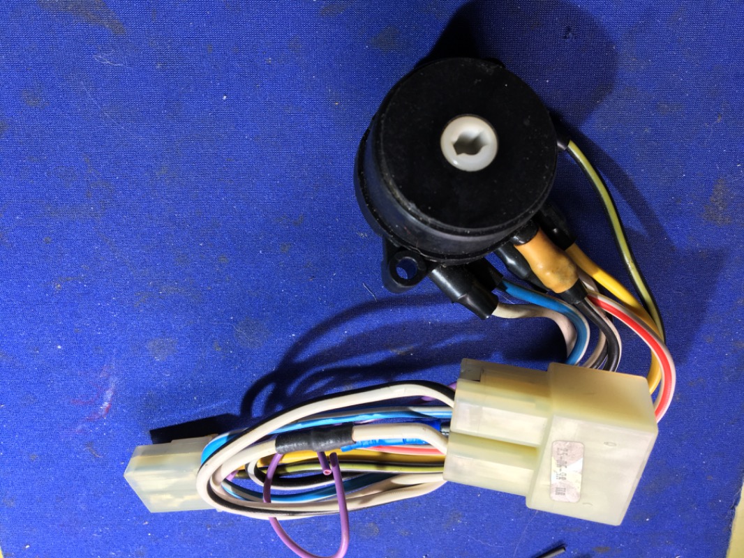

Replied by Airportable on topic MGTF - No Dashboard Lights - Ingition Switch to II
Posted 1 year 9 months ago #208697
I think there are two patterns of switch, early & late (nowt like stating the obvious) & I don’t think you can graft one onto the other. Electrically they are identical, if buying a used part do make sure it’s off the same family group.
An early f & a 500 won’t mix.
Again this post starts with “I think” & so someone might like to verify, I have a switch in store which I think is a Mk2 / tf, I can’t check against a Mk1 as my car starts electronically & the key just enables the electronics, the rest of it fell in bits, hence the electronics.

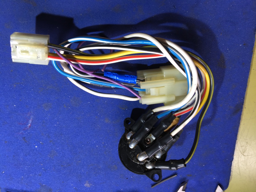

Posted 1 year 9 months ago #208704
I’ve just been in stores & found this, it might help identify what you have.
this is off a Mk1, dated 25-06-98.
