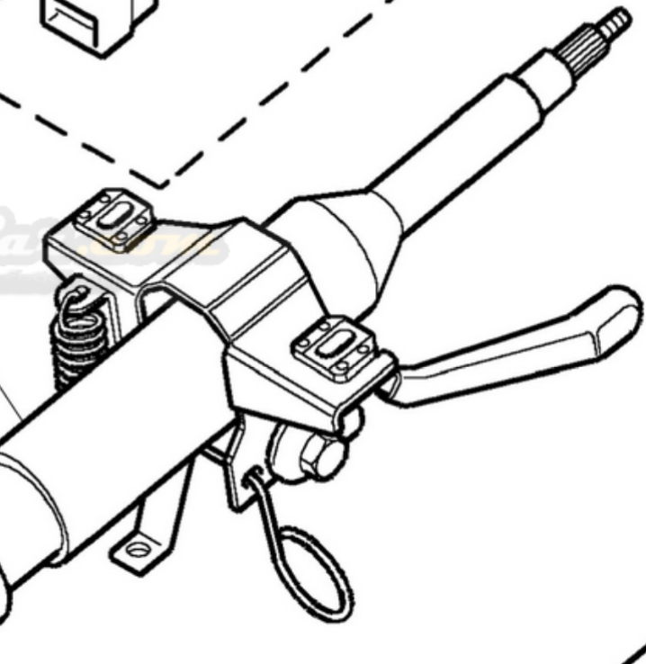

This is the area/mechanism where the issue is, I feel.

They look to be captive nuts illistrated in the line drawing hopefully they are still captive and  have not  broken free, if the have broken free it might explain why they're loose, some idiot previous owner may have used bolts with the wrong thread and seized them it to the captive nuts breaking the nuts free and they wont now do up!
I hope for your sake that isn't the case and they're just loose!

If you look at the illustration you put up earlier you will see two square items, which could be mistaken for captive nuts; they are not.
These devices are die cast “clips” held onto the shaft bracketry by nylon pegs. These are designed to shear if the steering column collapses during an accident; they are a loose fit in the mounting bracket if these nylon pegs are absent or sheared for some reason.
I would be taking the column out to inspect it on the bench. The contortionist is better placed to undertake this job or a grand child.
