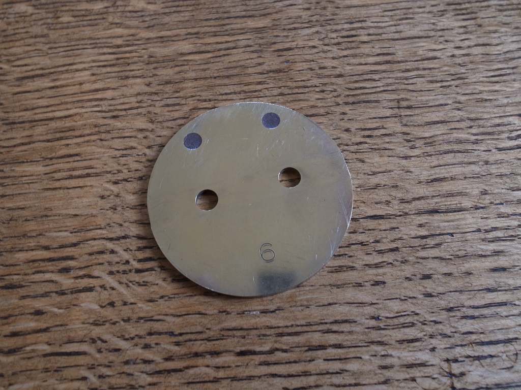

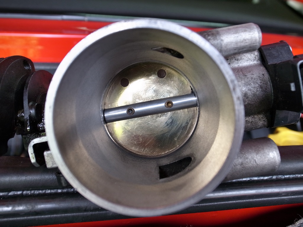

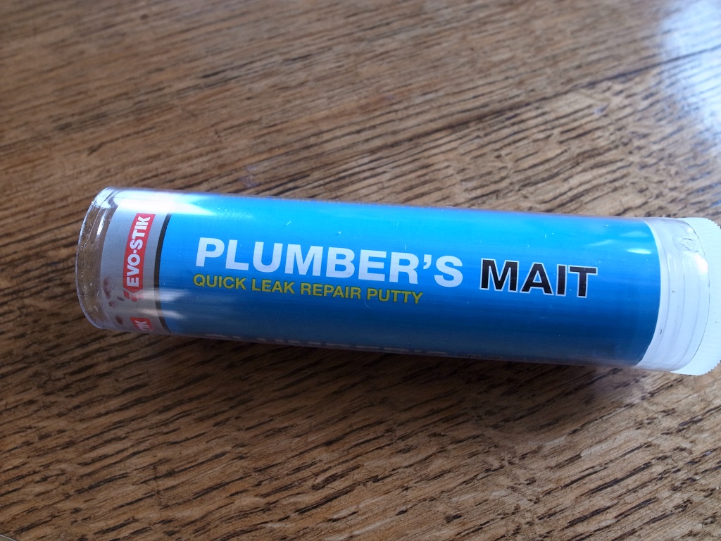

Despite being an avid reader of the T-Bar, until I was scanning through the 'how to's' I'd always assumed that the only way to improve a 48mm throttle body was to replace it with a 52mm version. Then I found this thread and its sister (the Mk2) and I removed the wedge from my 48mm throttle body this afternoon and the F seems to be running very well as a consequence. The throttle is 'sharper' and I've not noticed any issues maneuvering at low speed either. I used Evo-stick Plumbers' Mait to fill the holes.
This is the cleaned and filled butterfly:
The whole throttle body had been greasy presumably as result of 15 years of muck coming via the breather.
This is the Evo-stick - about £5 from B&Q. I pressed the fill quite hard with a biro when it had set and nothing moved. I also drop tested the butterfly from a couple of feet and nothing fell out.
This is the butterfly back in the body.
Anyway, I'd missed this modification for the 4 years or so that I'd been on the T-Bar so I'm highlighting it now in case others have also not seen it. If you have a 52mm throttle body you can ignore the thread as the wedge was not fitted to those.
