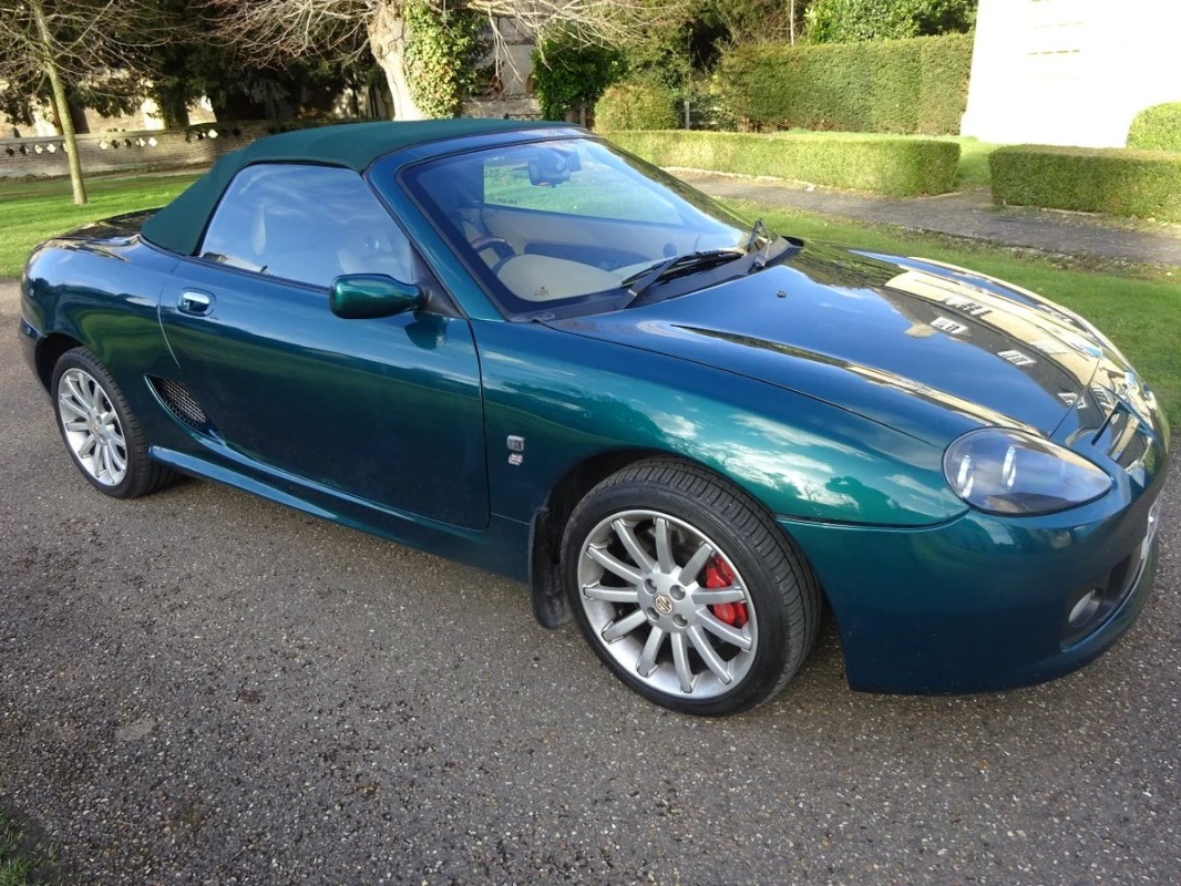

https://www.peterboroughclassiccars.com/mg-tf-2005
Looked to be a serious prospect.  Apparently deposit already taken - drat.

Cheers!   It did tick a lot of boxes!  Green hood as well. Still  - no rush.  That been 3 Anniversary cars I've seen so they look like having a good survival rate.
Still showing as For Sale - which is irritating.
