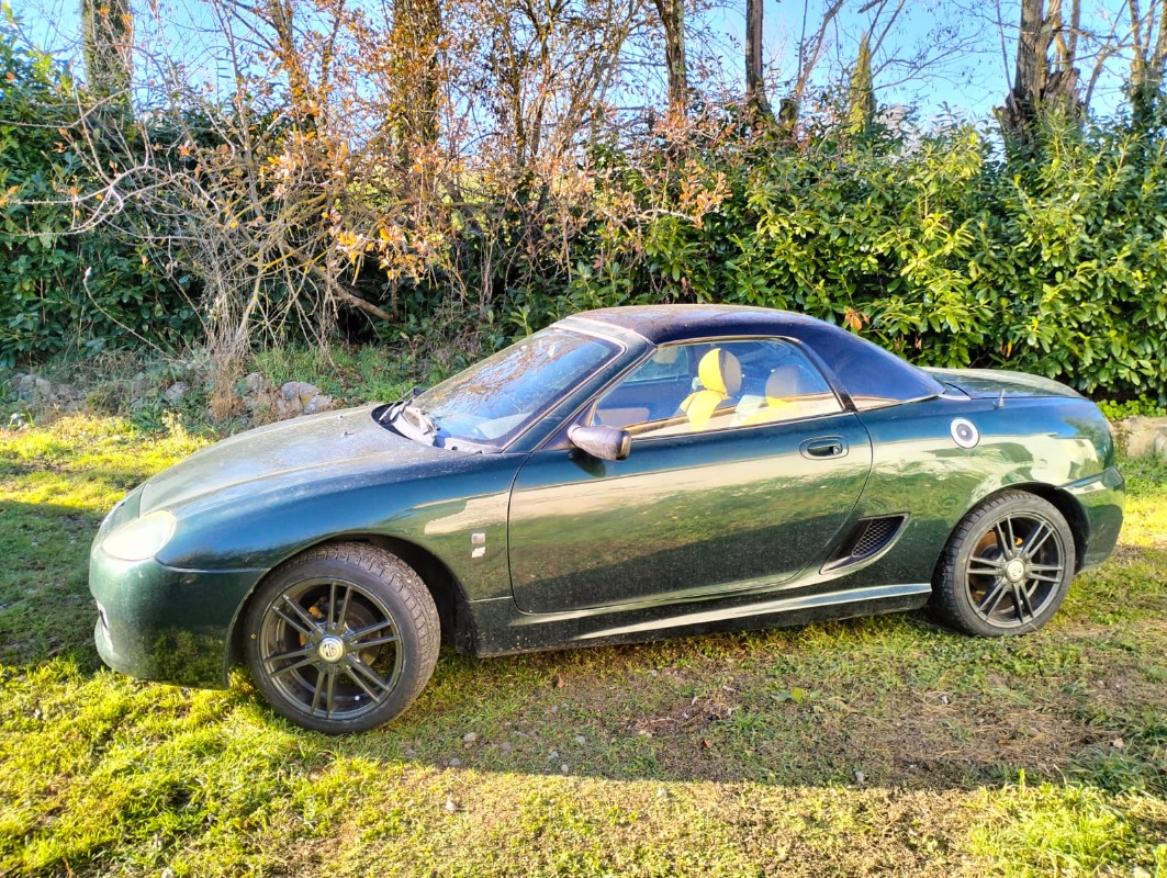

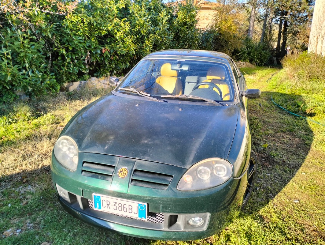

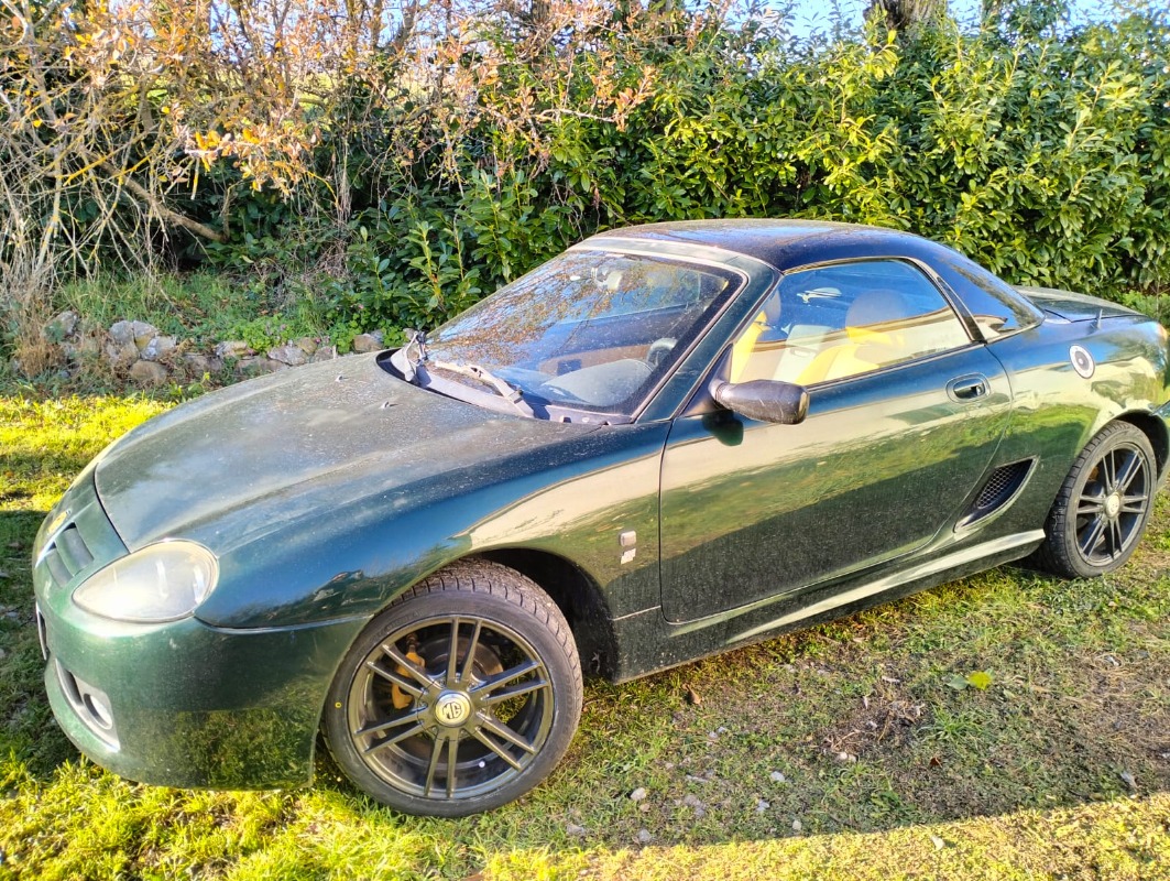

Some pictures of your TF with it's new tyres please
Replied by GalvanoBlu on topic My presentation and a problem about tyres
Posted 1 year 7 months ago #209885
Here they are!!!
But I would like to take this opportunity to ask you expert MGers... what kind of wheel does my car have? Yesterday I did some research: I looked through Roger Park's book, then on the internet, but I couldn't find them anywhere... they have the MG logo stamped on them but they don't appear anywhere, other than on my car.... has anyone ever seen them?
