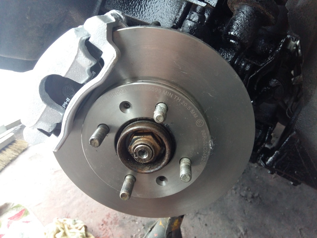

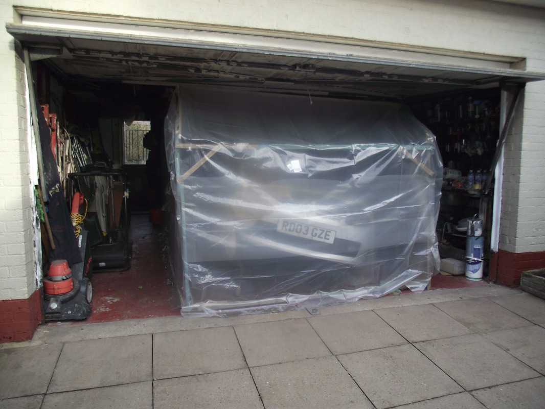

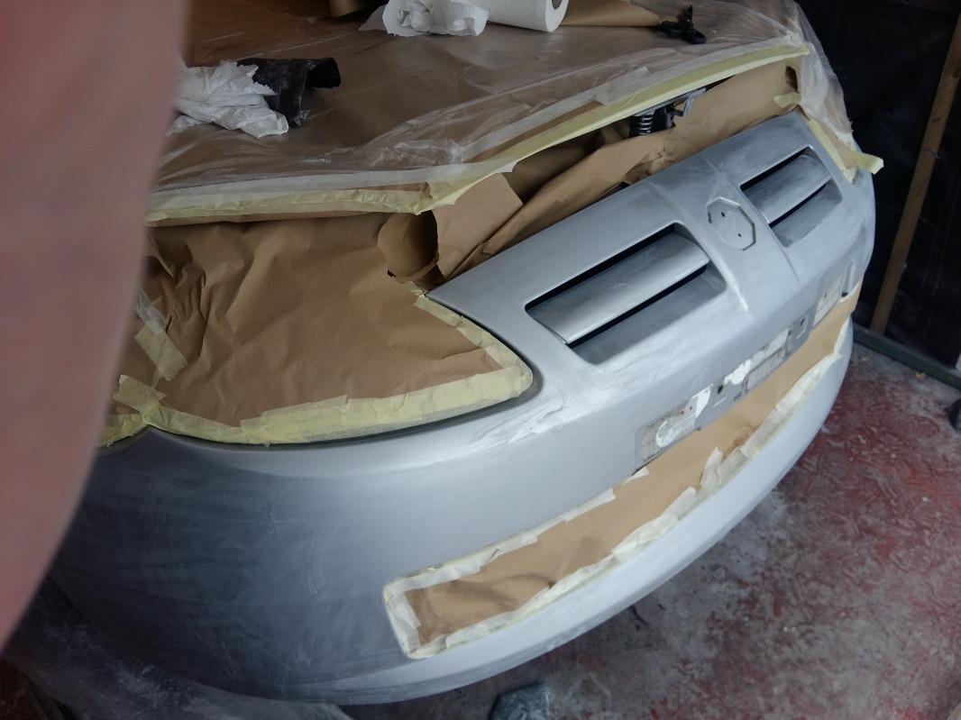

Morning Im restoring an MGTF , which I`ve been on for over a year now  I am having cancer treatment and I decided due to that and my age It will be the last car I restore It had an 11 months MOT left on it but it needed tidying up .The brakes just passed so I`ve fitted new rear callipers , discs and pads and on the front I recond. the callipers new discs and pads .I`m replacing the rear screen which was cracked and am respraying the body I set up a " tent in my garage to do this .One of the reasons I bought the car ,was for something to do when I feel like it ,which has been ideal I `reckon to have it finished before the new year  Looking at the car last week I decided the front bumper wasnt the same shade as the rest of the car .I was having problems with my spray gun ,so I`m redoing this when the weather is dry and warmer , any day now I hope .One of the main problem why I`m going to sell it ,is last year I was driving north on the M6 with my wife and a huge lorry hit us and wrote the car off .Fortunately he stopped and said he can`t see anything on his left as he is so high up !!! and thought we had taken the slip road and left the M6 .Now a solicitor recently contacted me, to ask if I could confirm one or two points ,as they were taking the firm to court as they hadnt paid my insurers for the accident .Until they do the case is classed as "OPEN" and its my fault .So the quotes I`ve had for the MG is over £900 ,this will hopefully drop once settled .but Ive been told it may be a while Ive restored over 30 cars as a hobby and never kept one anyway  If youre still interested contact me Len
