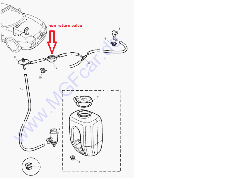

It's often at this time of year that a lot of people realise that their windscreen washers seem to have become feeble.
Often the problem is a build up of dirt/ gunk/ bacterial growth/ sludge etc. clogging up the pump pipes and or jets. The obvious answer is to strip the system and clean out all the disgusting slimey mess.
Another problem is the non return valve can if not working properly become a restriction on the flow.
You can buy a replacement, but it's easier to throw it away and join the two pipes up instead. This actually helps keep the system clean as fluid is not held in the pipework. Removal does not have any deleterious effect except that it may take marginally longer for fluid to spray. (I removed the NRV years ago.)Plus it means no fluid held at the jets to freeze solid!
Finally, to help prevent frozen washers use the correct strength fluid.

How to remove the MG windscreen washer non return valve bypass.

That's so simple and so useful, even I could do it... Can I claim an extra 5hp as my car would have an under bonnet mod?
Thanks for sharing.

When I got my F the washer pump wasn't working, I sourced one for a Rover 620 which was almost identical, needed a bit of fettling to get the plug to fit but this may be because it was a pattern part.
I then shortened the length of the hose so it more or less goes directly to the jets, removed the one way valve and fitted genuine citron mist jets, pattern ones have been known to be worse than the O/E pin prick jets.
