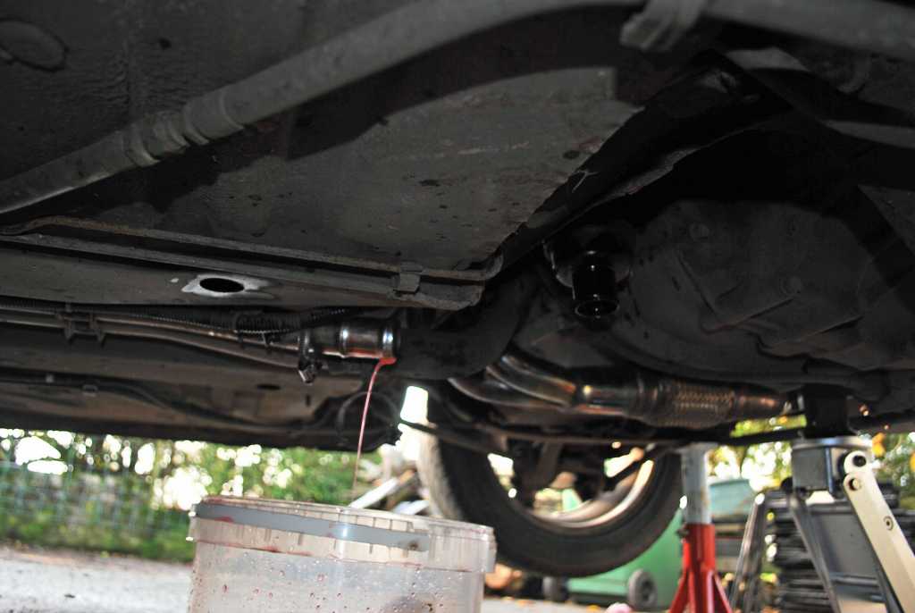

To access it, you will need to raise the rear of the car. I used the central jacking point to lift it and positioned axle stands under the subframe. I also chocked the front wheels. Ensuring that the car was safe and secure.
I released the rubber hose from the underfloor pipes positioning a suitable container to catch the coolant. And then opened the three bleed points - Radiator;Heater matrix; and return pipe in the engine bay.

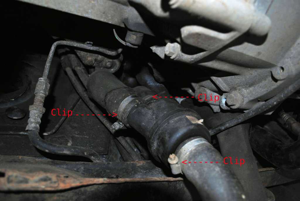

Once all the coolant has drained you will be able to undo these three clips to free the PRT module. Be aware that there will be coolant held behind the thermostat. (Does coolant help hair growth?)probably not... ;)

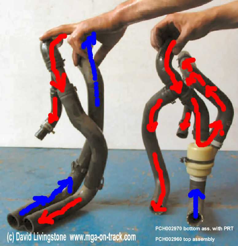

There isn't a How to as such.
I've got two photos showing the pipework configuration before and after.
This is how the pipework connects to the underfloor pipes.
This is how the PRT fits in, with the original again to compare.
The hoses connect to the engine and metal engine pipes in the same manner otherwise. Notice how the prt reverses the flow through the radiator. Obviously you need to replace the original thermostat with a blank.
