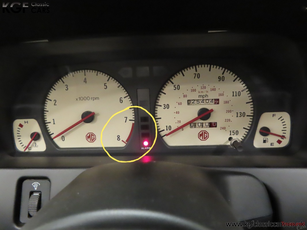

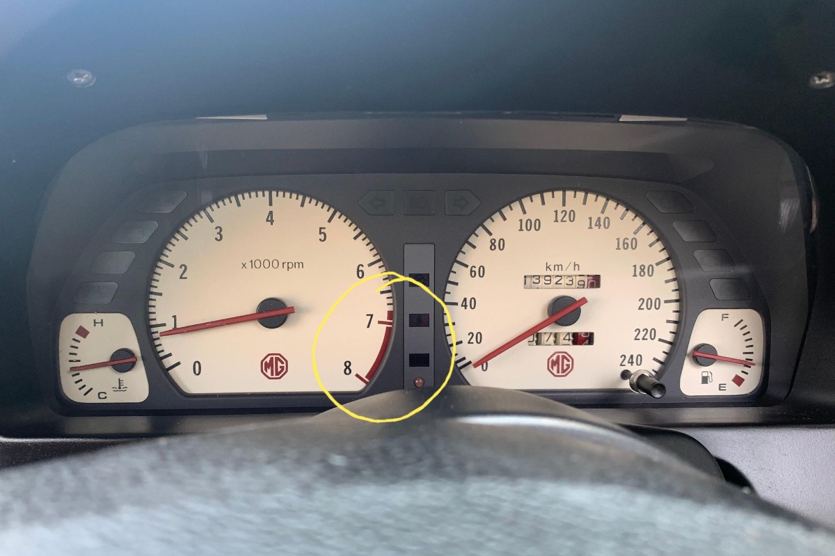

Beside VIN numner you do not hve at this moment, you can spot if car left the factory with VVC engine by looking at its instrument cluster.
120/135 engine is non VVC and its rpm iinstrument will have red line starting at 6800 rpms.
145/160 is VVC engine and its rpm instrument will have red line starting at 7200 rpms.
See below:
120/135 engine non VVC:
145/160 VVC engine:

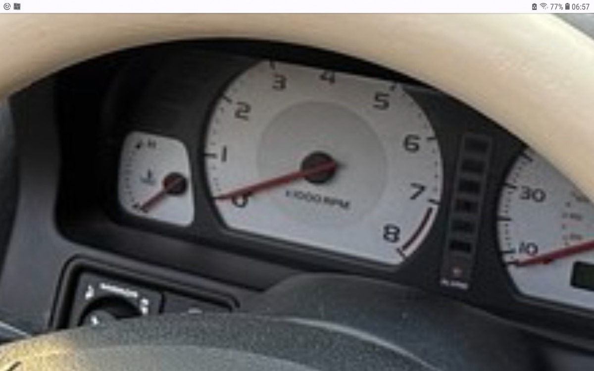

So by looking onto available pictures you can see rpms instrument:
and by that this car left the factory with VVC engine. Weather or not it have it right now you will need to see.
See below:
145/160 VVC engine:
