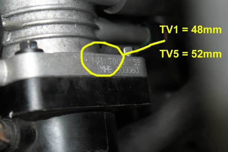

Well I've got and fitted an alloy throttle body of an mgzr. I don't know if it's the right one but it does feel a hell of a lot crisper!
by 240karl
Replied by Andy Lawrence on topic 2nd choice.
Posted 11 years 10 months ago #148409
It should have a 52 etched on the side.
WHALE OIL BEEF HOOKED
Replied by PQD44 on topic 2nd choice.
Posted 11 years 10 months ago #148415
Some had 52 in a circle embossed on the side or...
TV1 indicates a 48mm and TV5 indicates a 52mm throttle body.
Posted 11 years 10 months ago #148418
That's what I meant.
Replied by 240karl on topic Re:2nd choice.
Posted 11 years 10 months ago #148430
Bugger it's a tv1. Still feels better than the plastic one. I'll keep looking
by 240karl
Posted 11 years 10 months ago #148512
Is there such a throttle body with tv3 on? I've just had a glance round the scrappys, plenty of tv1.
by 240karl
Posted 11 years 10 months ago #148518
TV3 ? not that I know of, but then again that does leave a lot of scope. :lol:
Are you sure it's not a TV5 with a bit of dirt on making the 5 look like a 3?
Posted 11 years 10 months ago #148521
I hope so, I'll be back in for it tomorrow
