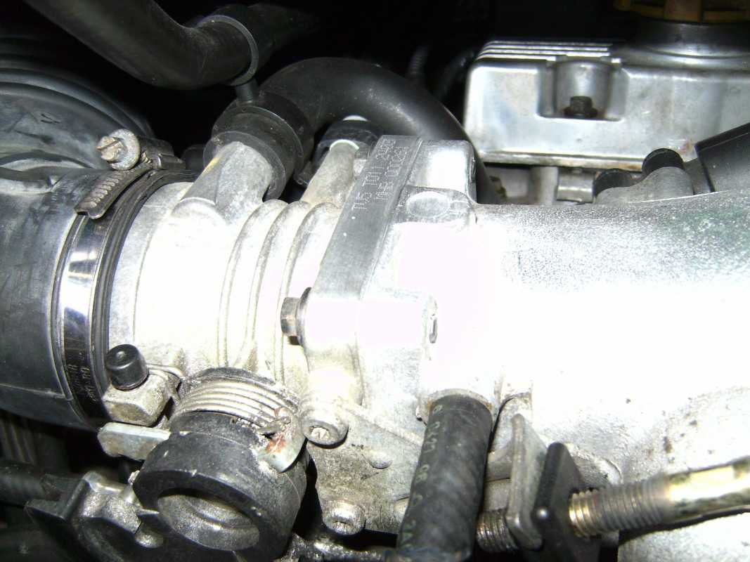

Posted 11 years 11 months ago #148236
Quick question, what car does the 52mm throttle body come off? I work next to a scrappers I'll see if they have anything in.
by 240karl
Replied by PQD44 on topic Re:2nd choice.
Posted 11 years 11 months ago #148237
Fitted as standard to the MGF trophy and TF 160. Will also be on MG ZR, ZS, ZT with 160 engines.
Replied by Badger on topic Re:2nd choice.
Posted 11 years 11 months ago #148253
240karl wrote: Quick question, what car does the 52mm throttle body come off? I work next to a scrappers I'll see if they have anything in.
Could be fitted to a lot of marques fitted with the 1.8 K series engine as per PQD44's previous post.
I got mine from the scrappies, it came off a Land Rover Freelander, I only wanted the alloy manifold but had to buy the complete manifold for £35, when I got it home and cleaned it up it had the 52mm throttle body and the blue fuel injectors 'spot-on'
There are some identification marks on the top of the throttle body flange "TV1" is the 48mm and TV5 is the 52mm.
If you take a wire brush or some wire wool and clean the area on the flange the marks should be easy to see.
The identification marks are on the image below.
Brian.
by Badger
