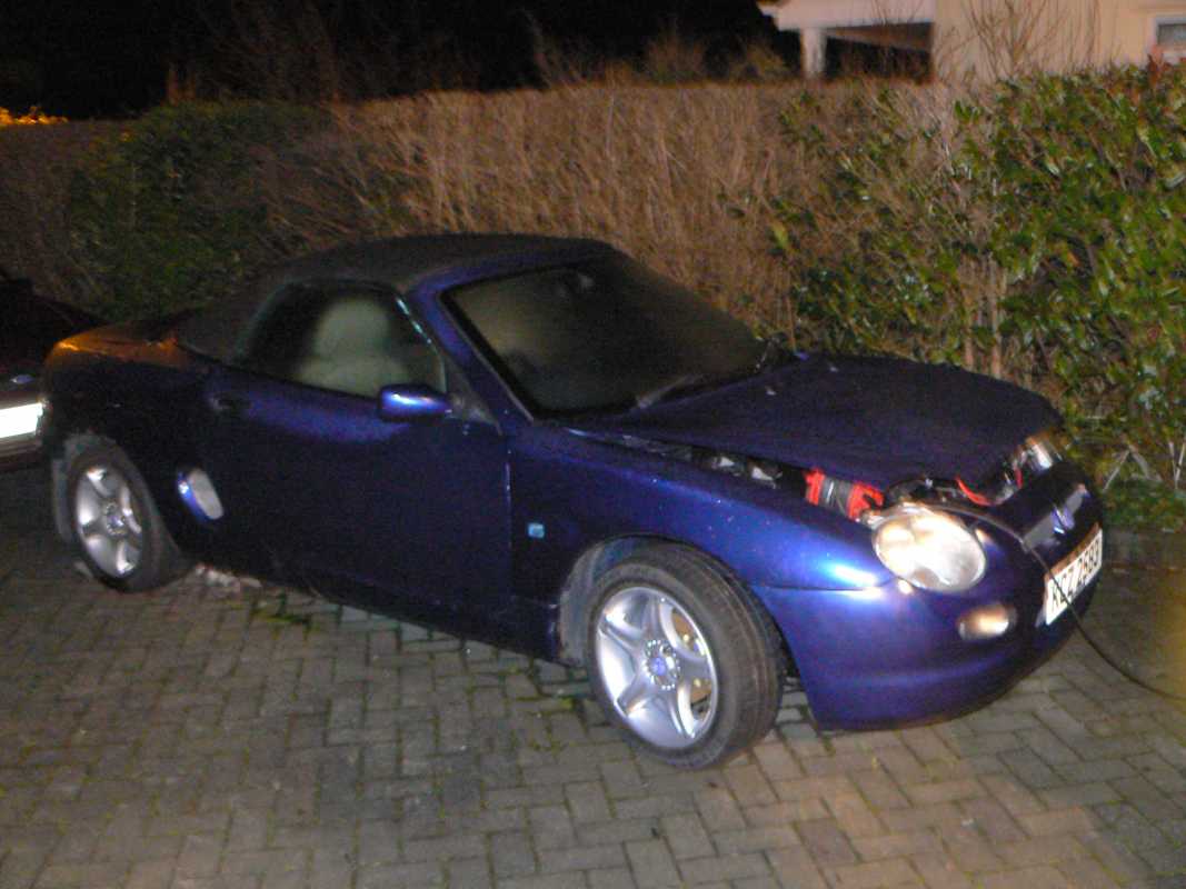

So it been has been over 2 months and no work on the MGF - shame on me

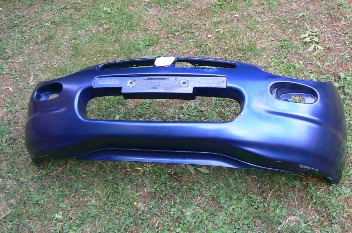

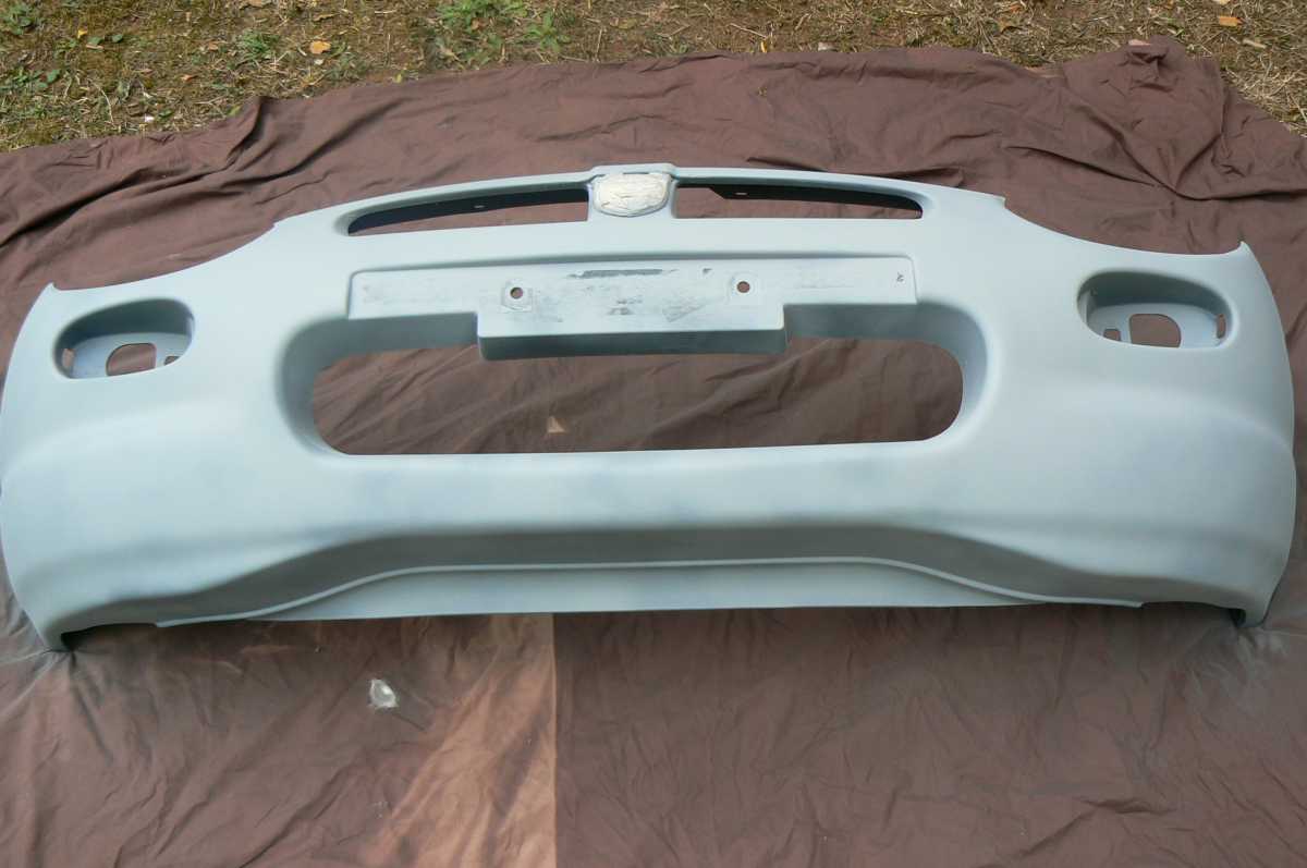

, too many other jobs on tye to do list... so shes had to take a back seat, but this weekend she got some desperately needed attention... Front bumper was rubbed down and prepared with plastic seal before the undercoats goes on,

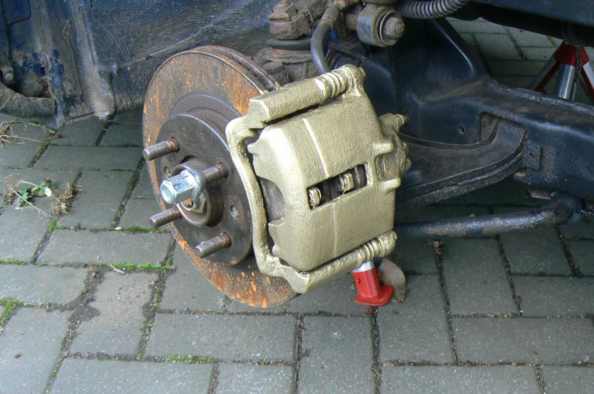

While that was drying, I took an electric drill and flapper wheel to the rustings front brake calipers (as can been since in prevoius pics they looked a bit shabby).... an hour on each side and a nice coat of smooth hammerite gold makes them look far better.
by MrOrange

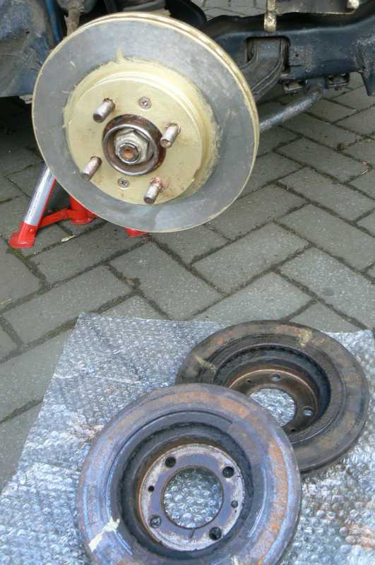

After looking at the front discs and seeing how poor they actually where I got a pair of used ones off ebay for £16 plus postage , only light surface rusting, so spent some time preparing those, since I had the gold paint thought I would touch up to match the calipers.
So to change them it meant geting the calipers off......easy job I thought., only 2 bolts each side ... never anything easy on this MGF, again stuck solid. only managed to get one bolt off, rounded off 2 others and left the other one, as really was not getting anywhere fast. :bang:
Got a mate's impact hammer and socket set, had another go and still would not budge, made a nasty mess of two bolt heads though ... hours later gave up and went and got a rounded bolt remover set .... another lesson learnt... as with that it was 15 mins and one caliper was off, nipped round to the other side and bingo.... so easy when you have the right tools. removed pads they where shot, so new ones ordered
Cleaned up one side of calipers and wired back the other part to get at the discs. Same story here... locking screws easily came out ... but discs was solid...tried the how to tip with the bolt/nut push off combination and bent the bolts .. that said didn't have the right size blots... so set too with lump hammer and tapping (well bashing) alway around eventually broke them free. Cleaned up hub and put refurb discs on ... another job done.
And bumper undercoated as well...

1) Get front bumper back on - yes its been resprayed blue, but just sat in the shed !!

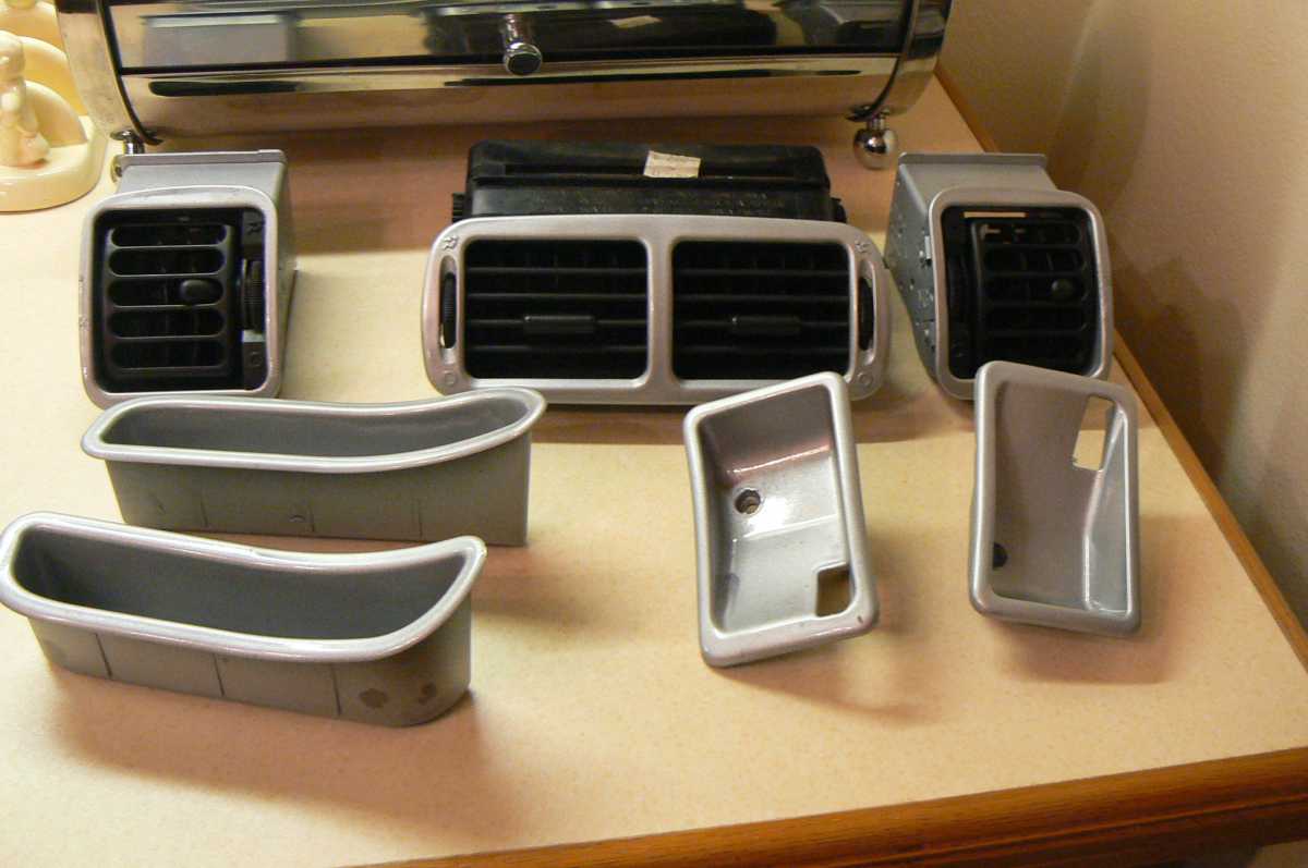

bumper back on , set of replacement 5 spoke alloys fitted and interior air vents taken out rubbed down and sprayed - some pics , console is in Tahiti blue to match car, but that is only 1st coat the other bits are ready to go back in ... tomorrow

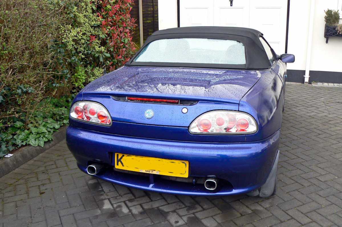

sorry for poor quality photo of car - a late finish... note bat is on trickle charge .... as just been sat waiting for me to get back on track..

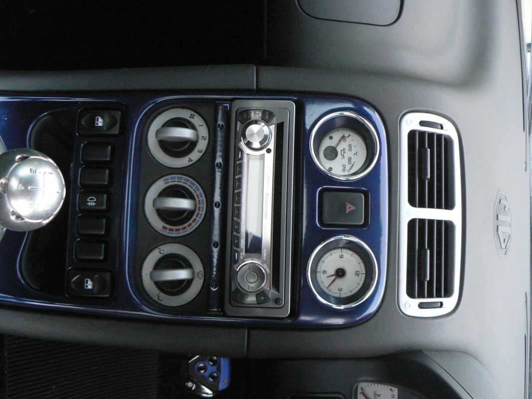

So the center console was finished and fitted - swapped back black seats as looks better with the silver trim

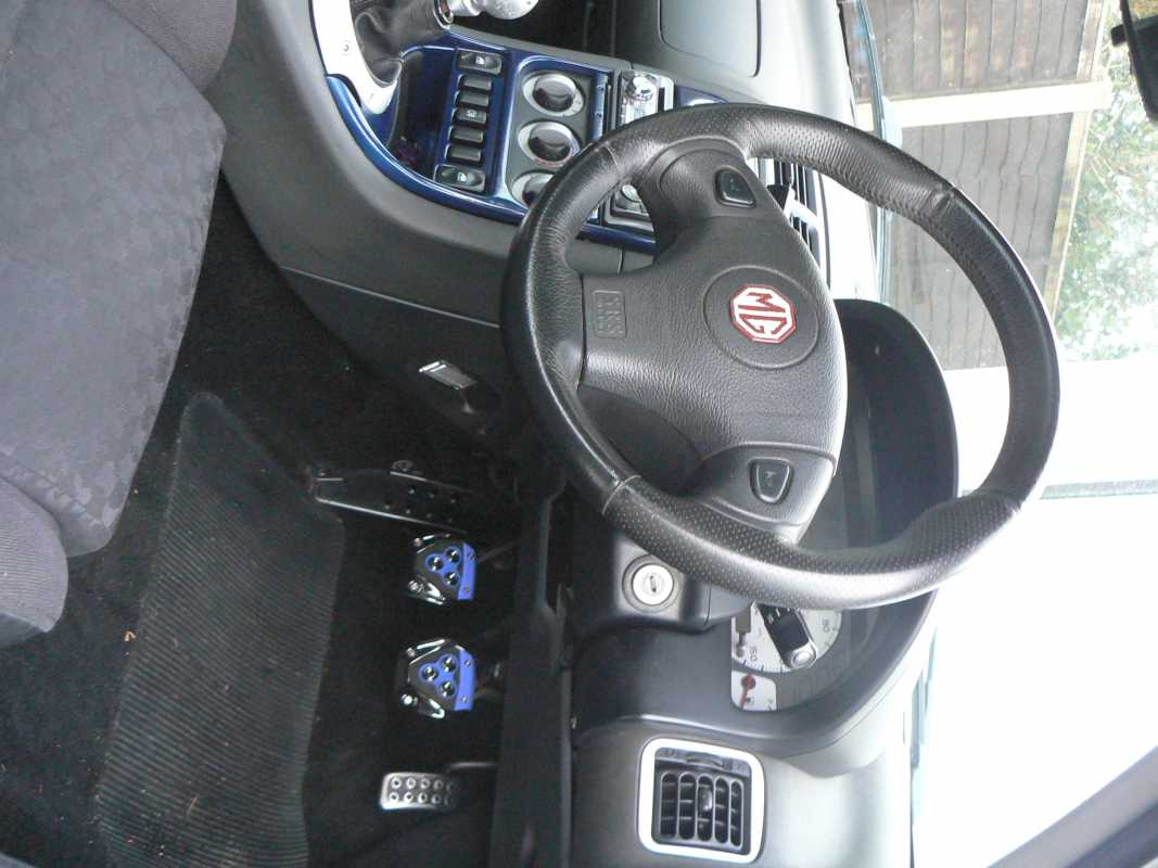

Also added a couple of blue pedals as origianls were getting worn

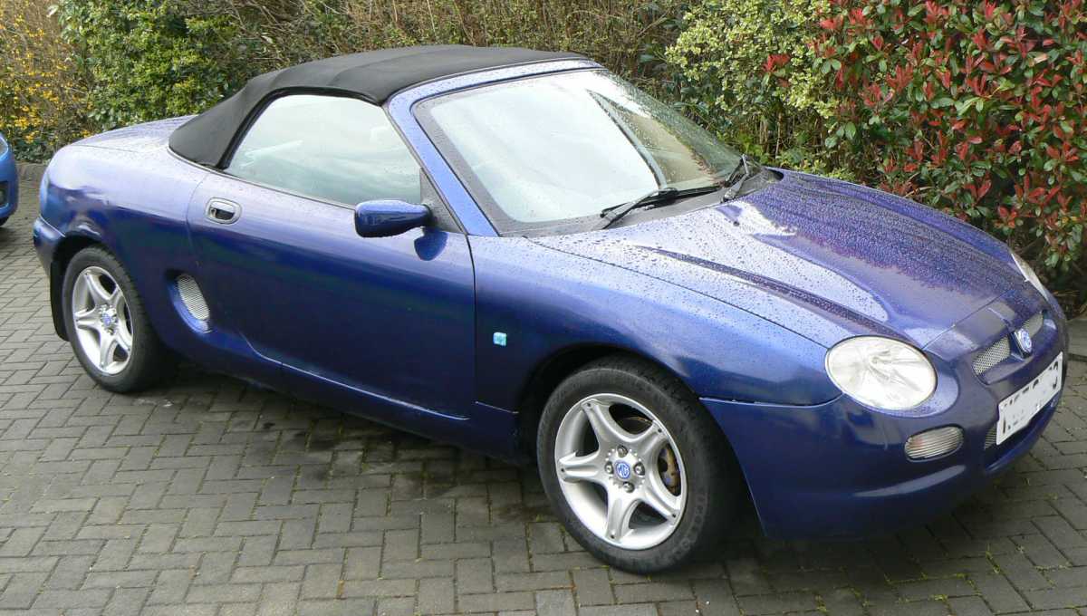

Managed to get to work on the F over the weekend, the alternator was still spinning free with no noises, so that went back in with a new belt, tested the voltage and every thing is sweet.
Also picked up a set of Lexus rear lights and fitted them, bit pricy but hopefully when it goes up for sale it gives it a bit of an edge on others. Also think they look cool.
Changed the air filter, flushed and drained the system and topped up with new OAT coolant, pumped up tyres, put it all back togther and then gave it a good wash and wax polish. Decided against the Viper stripes and race number decals as that may not appeal to everyones taste.
Also had another go at the interior well lights, door cards off (yet again) and checked wiring runs and disconnected and sprayed each connection and forced contact spray into the locks, as suspected I think it was the micro switches in the passenger door lock, its still a bit tempremental but at least they do come on and dim out when both doors shut , and so it was not a broken wire some where in the loom.
Tasks left is to change plugs, oil and oil filter and she will be off down for an MOT.

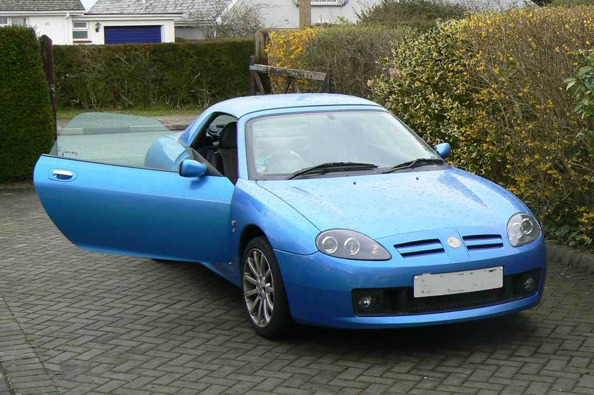

Also fitted the rear speakers and alarm sensor to the TF a it stopped raining - it was a straight swap with empy t-bar and plugged straight into existing wires ... sounds much better with fours speakers and can play with the fadar control now :lol: So sat in the car and armed the alarm to test it.....not sure how sensitive it would be ..I turned my head and no alarm, so went to turn around to have a look .. bingo ..still made me jump ..but it works :woohoo:
Here is the new toy...
