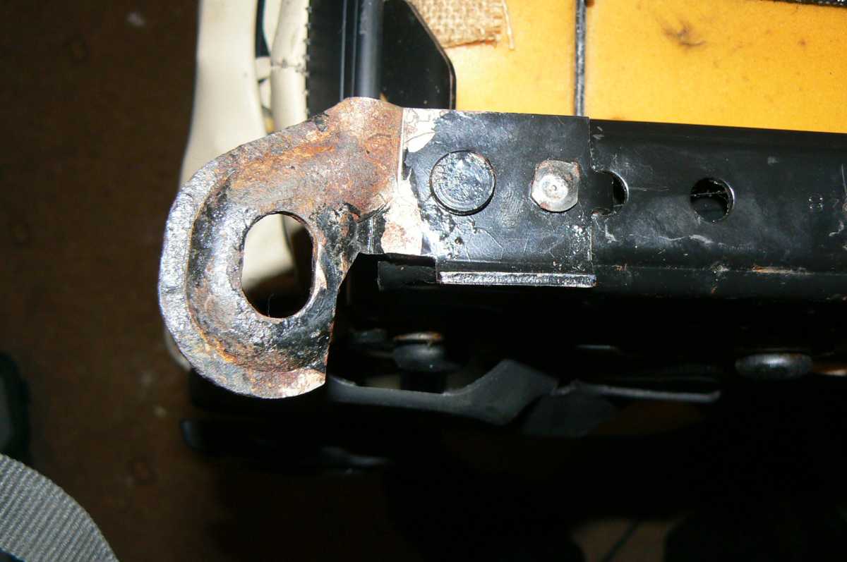

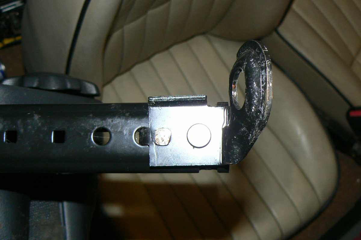

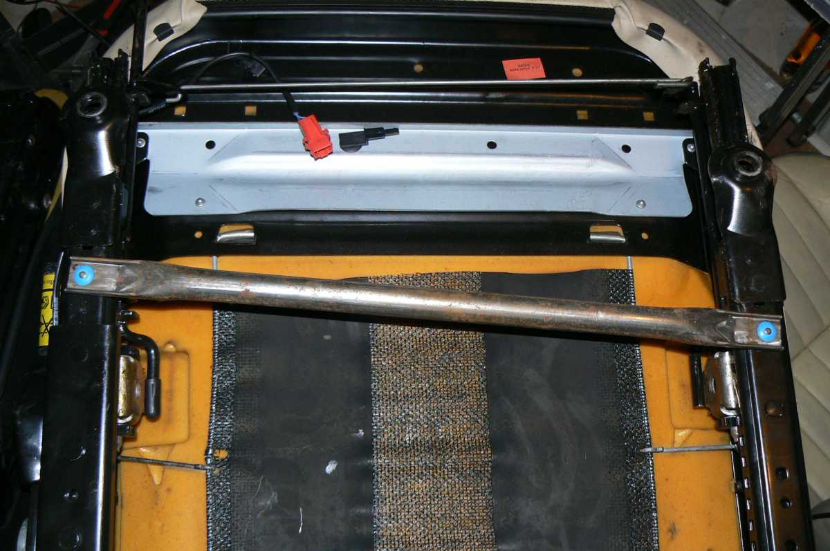

Thanks - yes I am the numpty - :oops: - got the camera to take a photo and all becomes clear ;) trying to do the swap in semi-darkness is not recommeded - in the light of the gaarge you can see what's up - looks like the leather seats wear not taken out carefully and the end bracket is actually been bent flat - sods law it was the passengers seat... also the runners where not aligned one must have been stuck so was not moving in sync - lesson learnt - check old against replacement firstt - dont rush in !
The orginal good end
And the bent one
And runners not aligned
So will sort this out and have another go !!
Have freed up the jammed runner - so they now move together and looks the same as original - so hopefully a pic with them in tomorrow !! :broon:

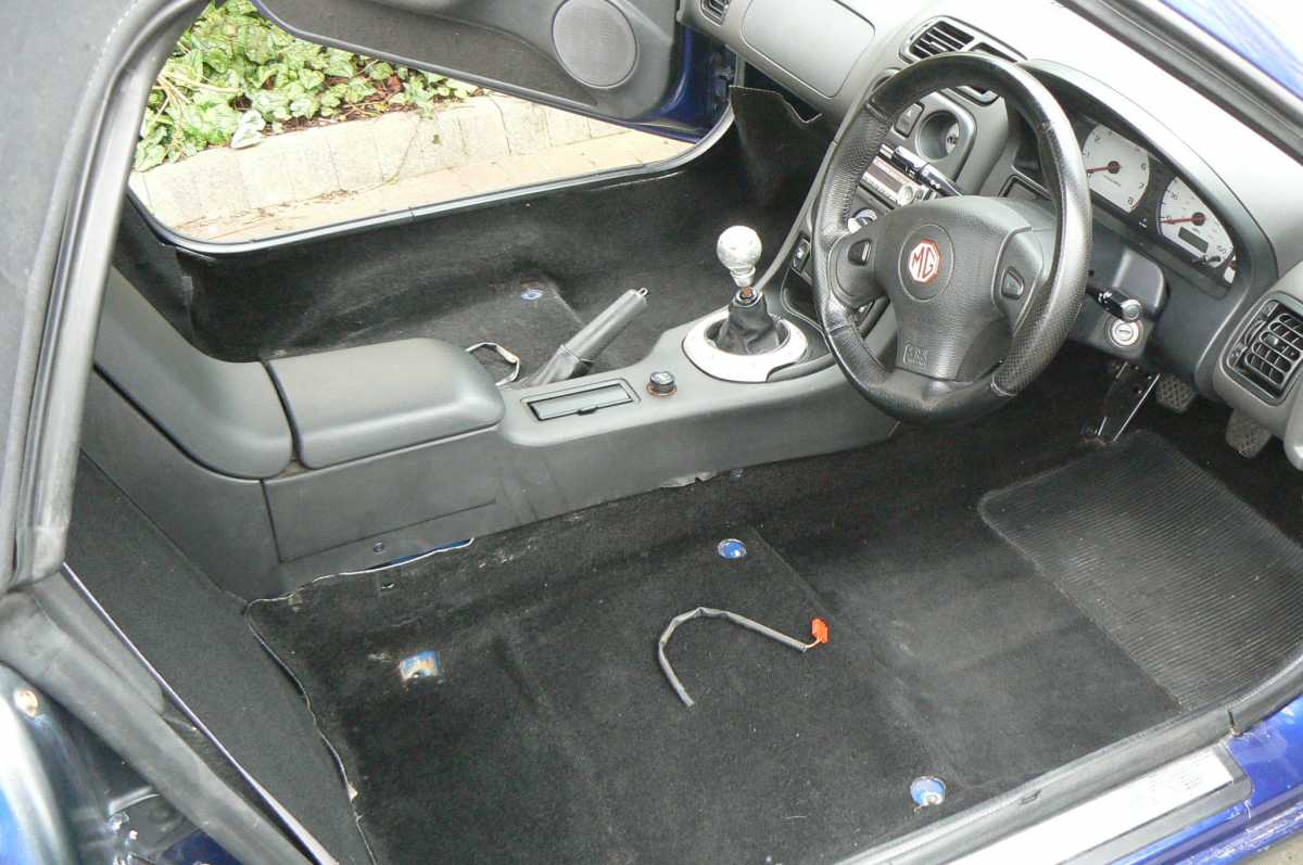

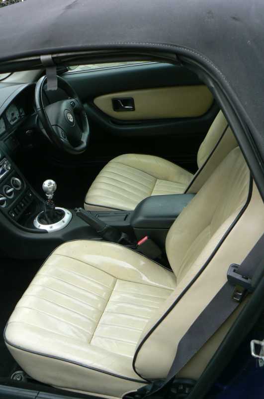

So the old cloth seats out.....
and replacement leather ones in..
Went for a spin and they do feel a bit higher than the old ones but the spring/support seems to be far better..so worth it :broon: .

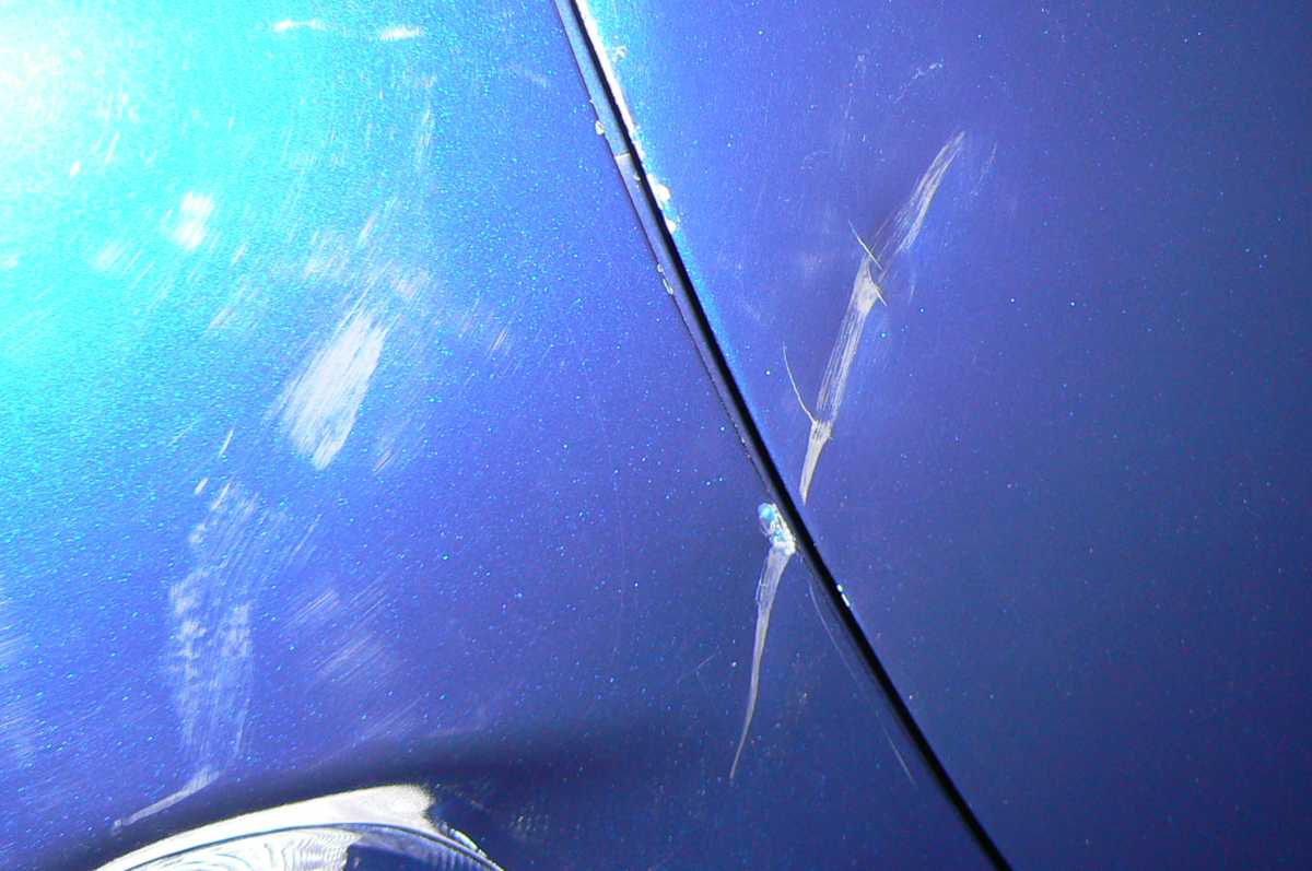

Also having had a closer look at the paint work it is showing a lot of small scratches (everywhere!!) so will have another go but this time with G3 scratch remover and then high gloss polish - yep still need to do the rust spots... and fix the interior lights and get under it and start having a good look there too ..... but made my mind up I am going to go for white viper strips once the paintwork is sorted

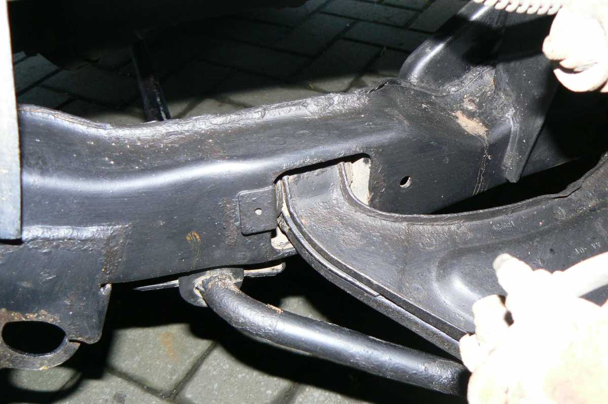

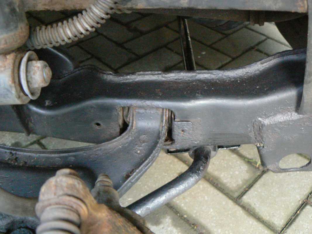

Well a Bank Holiday weekend with sun !! So jacked her up and had a look under the front .... sub frame was showing a fair bit of surface rust but did not look too serious. Swing arms seemed to be in pretty good nick, again mainly surface rust and build up of dirt.

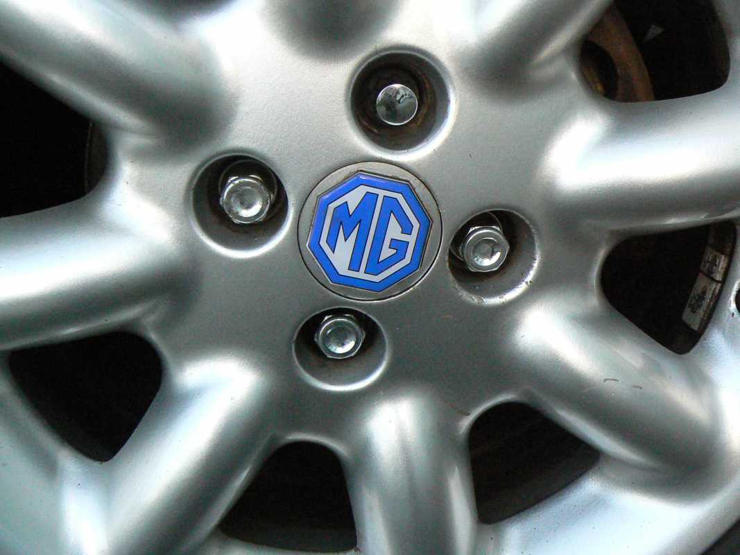

So wheels off and give it a wire brush and treat with Krust. Thought it would be a simple job... no such luck. Wheel nuts where the fist hurdle - solid as a rock, even jumping on extended break bar they didn't want to budge :rant: So overnight soak with perertaiong oil and another go, bit more brut force and manage to get them free eventually. Great, but...hang on the wheels still would not lift off. Both front wheels where like they where still bolted on! Had been told that alloy against steel drums can cause a chemical reaction that is like weilding parts together, they weren't wrong. So took a lump hammer, wood block and about 20 minutes of banshing the hell out of it to free them off.
Obviously these had not be off for some time and the person before may not of heard of copper grease. :-?
Anyway set to work with the electric drill and wire brush fitment and gave the subframe a going over, couple of hours later was ready to brush way the mess and then painted over with Krust. No major issues found (thank goodness) and it looked a lot better than when I started. Cleaned up the hubs, disks (may need to replace them sooner rather than later) and the alloy wheels and put them back on, with a new set of wheel nuts and copper grease :broon:

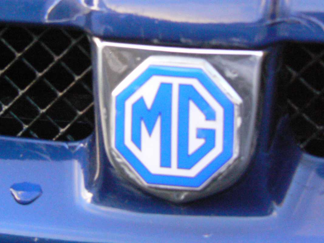

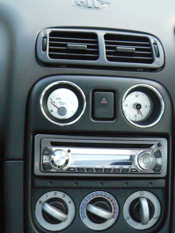

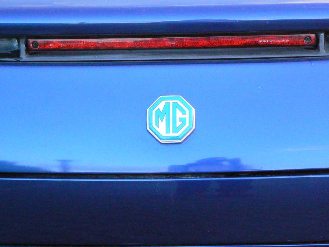

A few pics before I get nabbed by the photo police.....new blue badges...
Console with chrome surounds...
And the work after clean up and Krust applied on front sub frames
Also had a go at the rear offside wheel - same thing solid as a rock ..

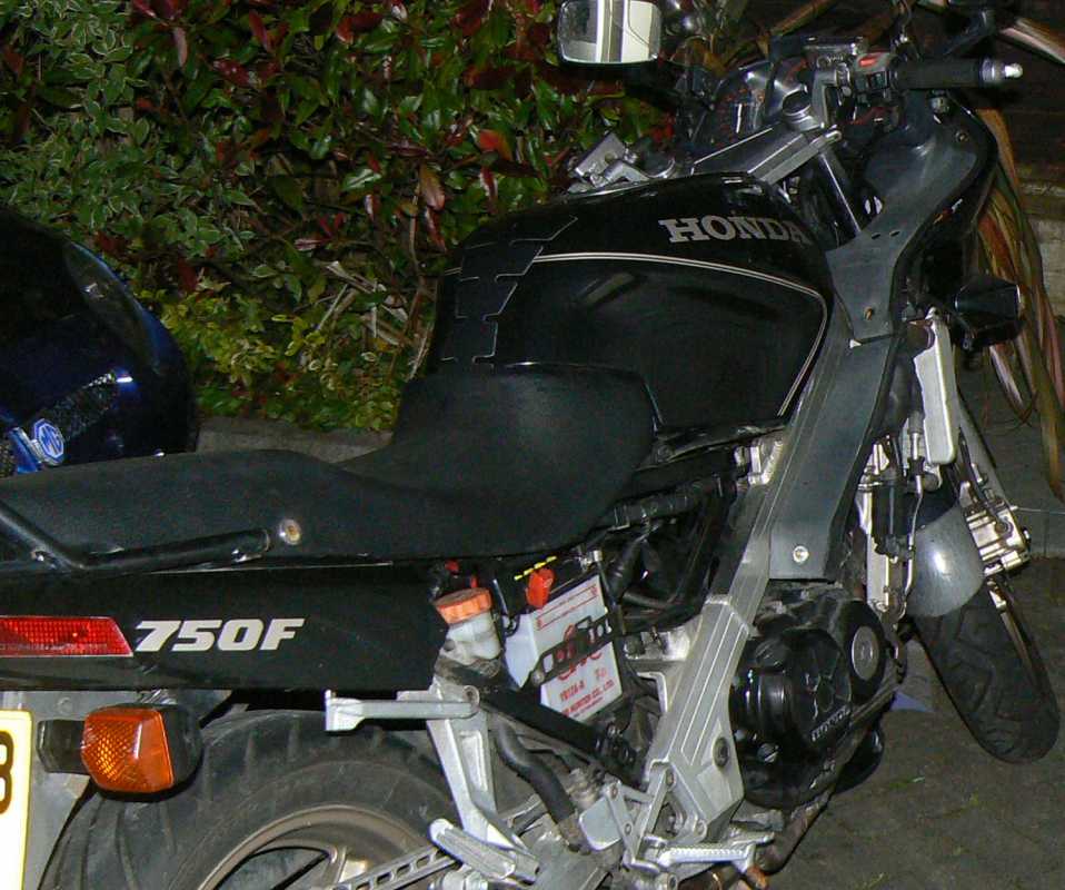

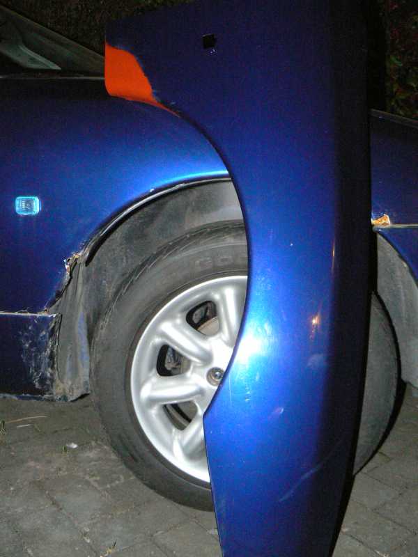

Oh dear got side tracked as needed to get my other toy out of the garage and give her a service before she went back on the road, she is old but still capable of doing near on 150mph - wind in your face, heart stooping, excitement. But she's got a mean streak and got well jealous .. of the shinny MGF parked in her spot. So servicing the brakes and putting the front wheel back on , she (VFR 750) promptly fell off the jacks and remodelled the MGF's door and wing- :bang: - Oh well more work... and a few pics of the front wing before replacement .
The nasty bike -
The damage
The front wing before the replacement
At least the weather's better !!

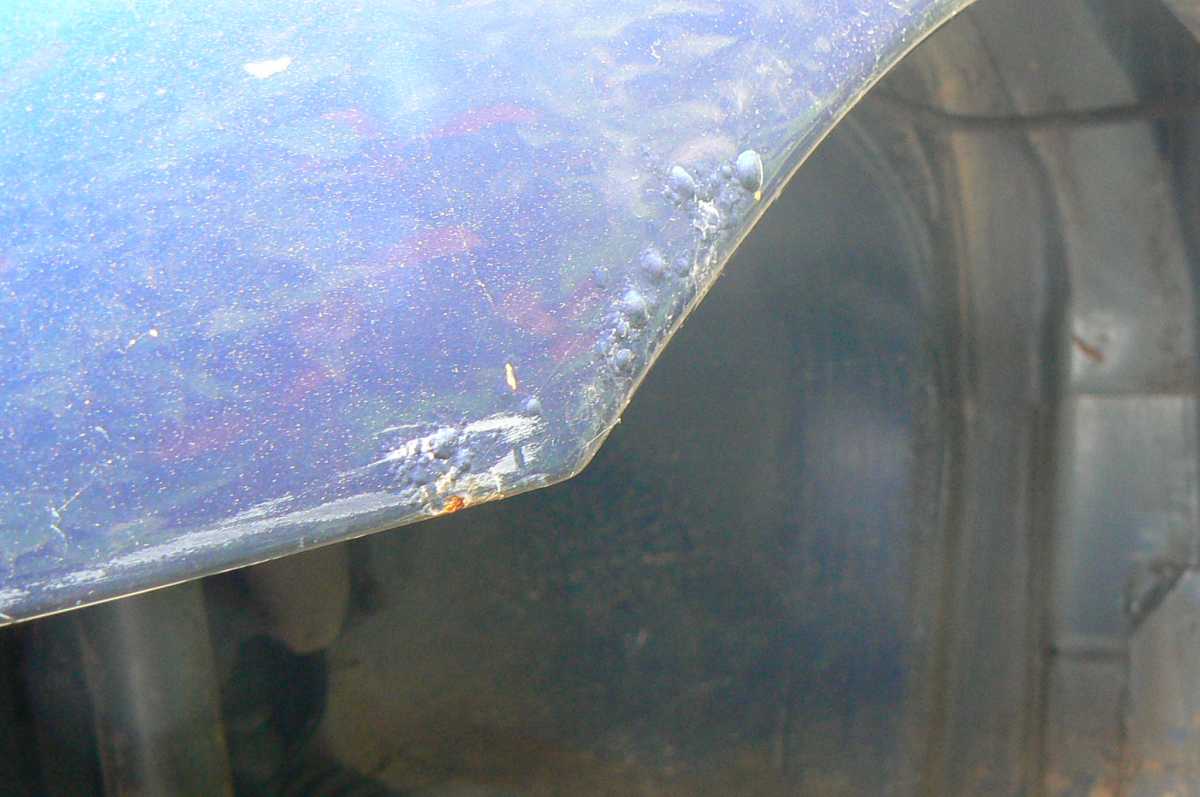

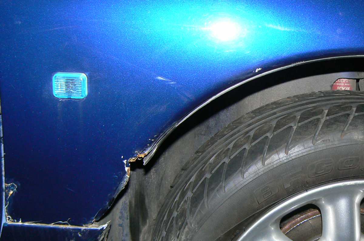

Spent a hour preparing the replacement wing once I got home from work - afraid it had bubbled paint in one corner but the rest of it was very good , so rubbed it back to bear metal with a flapper wheel, no holes appeared , Krusted it and applied a red oxide primer. Will rub back primer , give it coat of dark blue I had in shed and then two top coats with the orignal MGF paint - so fingers crossed it will look OK with a bit of rubbing compound - Here it is so far against the orignal

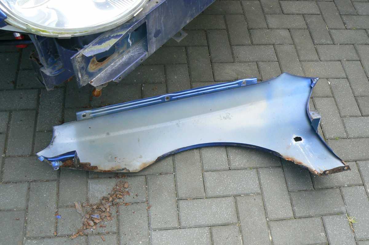

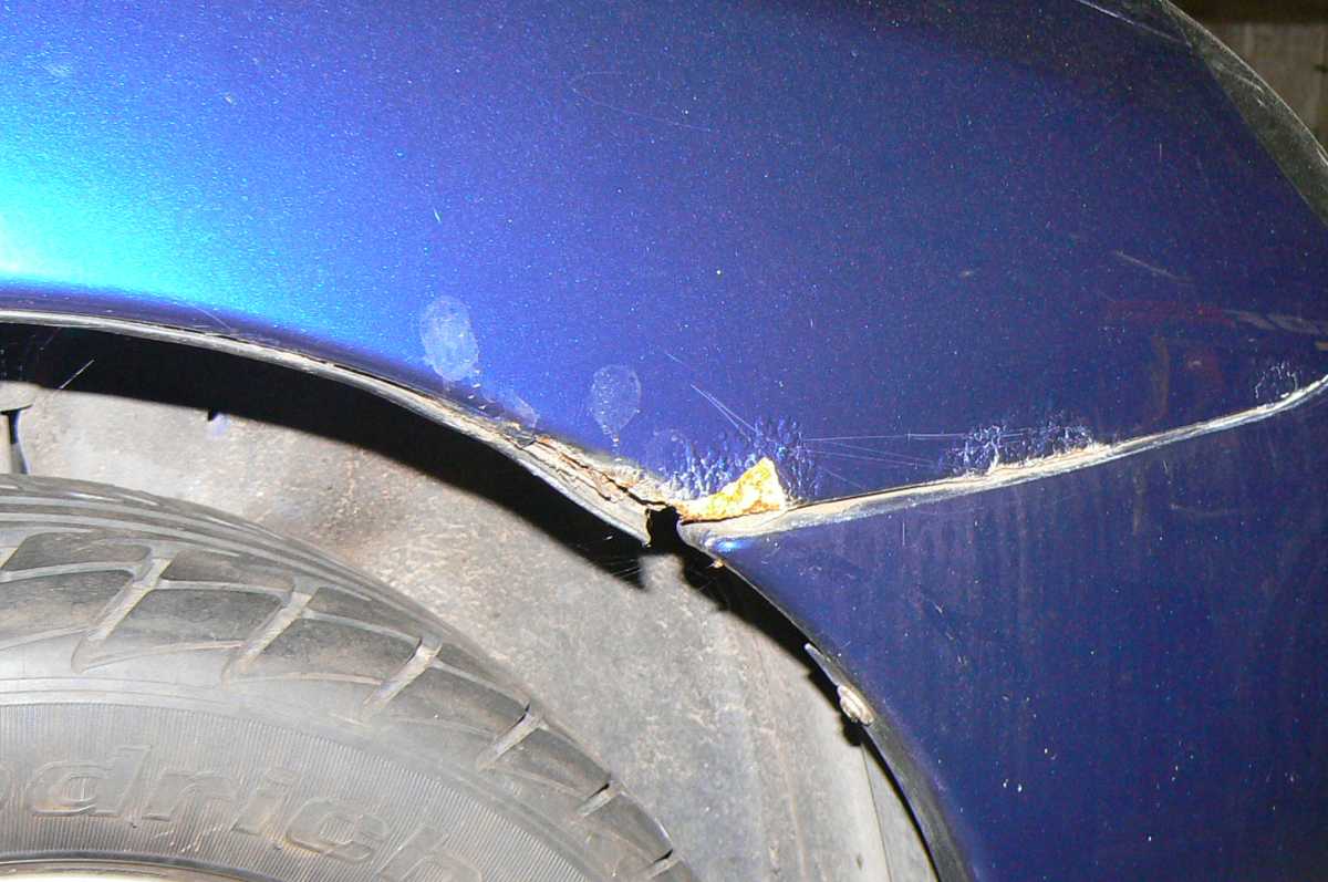

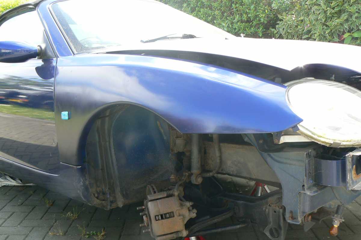

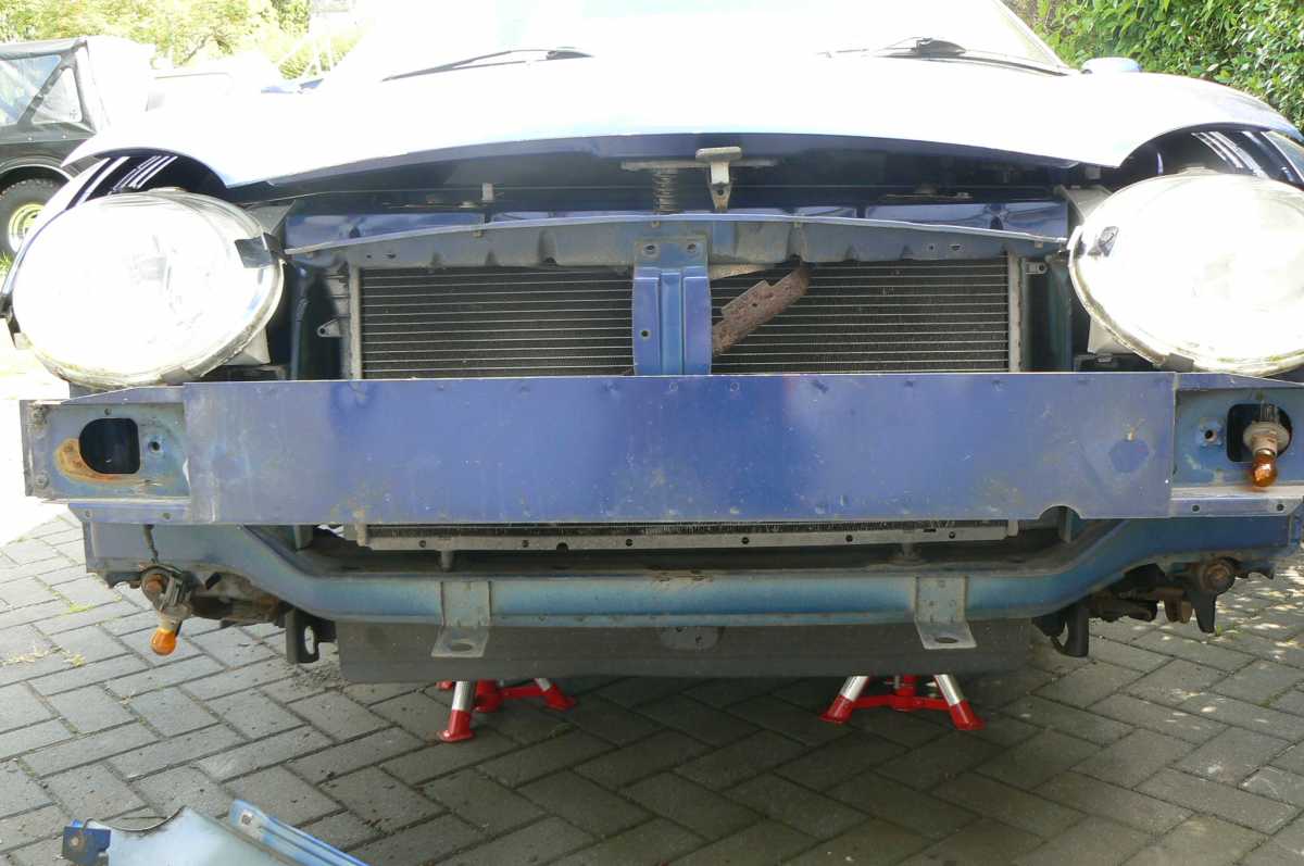

Again been sided tracked with other issues - so the poor old MGF has been sitting waiting for attention, and the dead line for completion sadly passed by but yesterday the time came to tackle the task - replacement wing had been resprayed and was ready to go, but will need a good polish to make it nice and shinny but that can be done on the car . So on with the job, followng CJJ's how to on front bumper removal - nice one thanks really useful, and a further hour messing around with corroride bolts on the wing it was off. the car. So here is a couple of pics - as you can see the old wing was a mess - note the pile of rust beside it !!
thnk I need to take the other wimg off and repair while I am at it
Looks a bit sad without the front bumper - that also needs a bit of touching up as well
