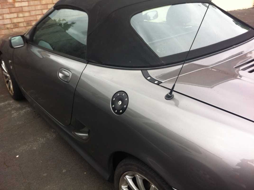

Black Deck Finshers now to match fuel cap. Not sure whether to keep them or not.

Replied by Jack of Hearts on topic Re: My TF160 (and the demise of my Metro)
Posted 14 years 1 week ago #57679
Jon have you thought about painting the fuel cap xpg? Leaving the black surround would look pretty trick
