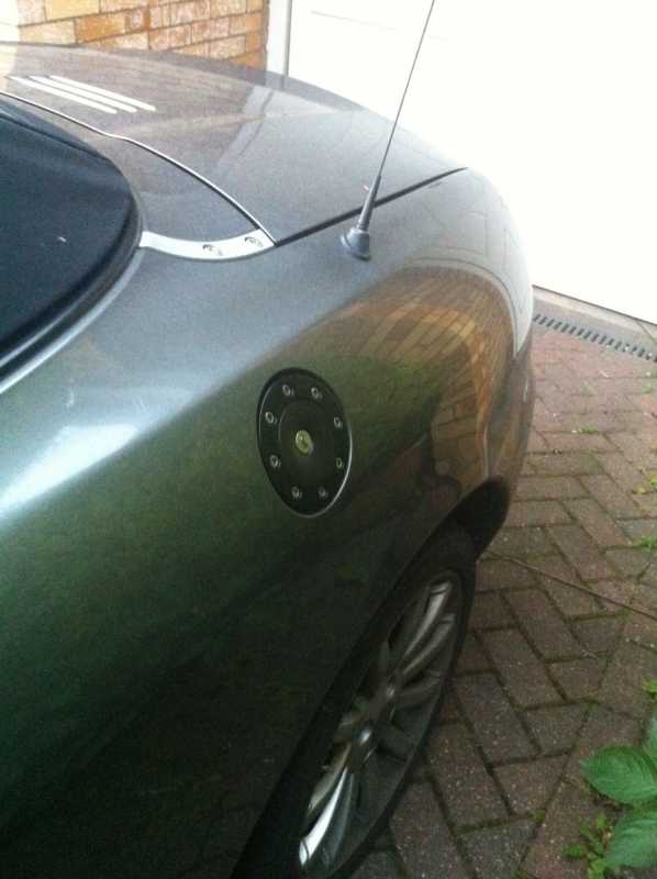

Small update - changed fuel cap. Just waiting on deck finishers to match now :)

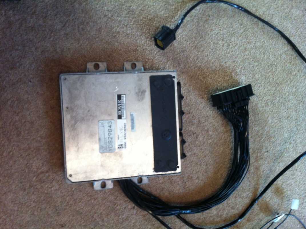

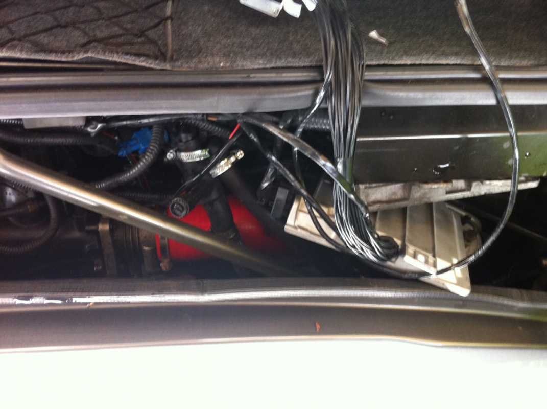

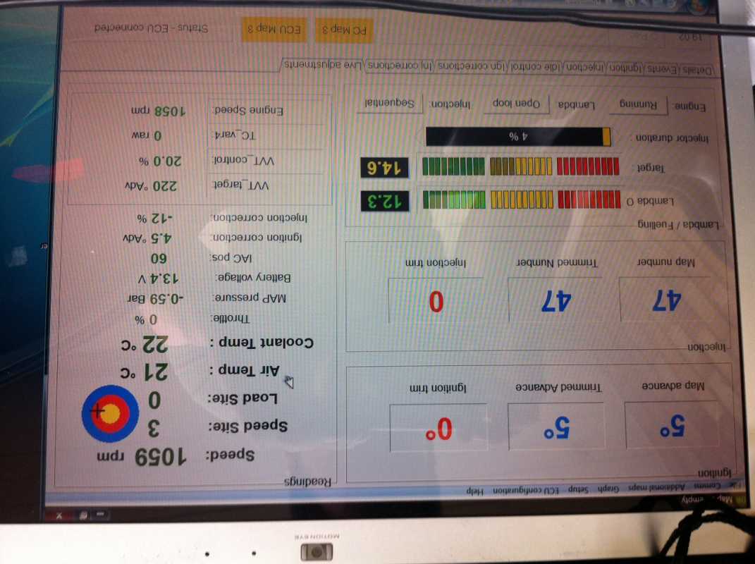

Re-wired my Emerald harness adapter so the K6 could control the MEMS3 stepper motor (My main reason for changing from a K3 to a K6)
Car starts and runs :)
Now I have to make a new adapter as when I started this one, the engine was in a Metro which only has one cooling fan and no planned air con.
Replied by MG mad on topic Re: My TF160 (and the demise of my Metro)
Posted 14 years 2 weeks ago #56219
I thought after the second image I was thinking you were standing on your head to take those photos... and then after the third, realised you definitely were.
