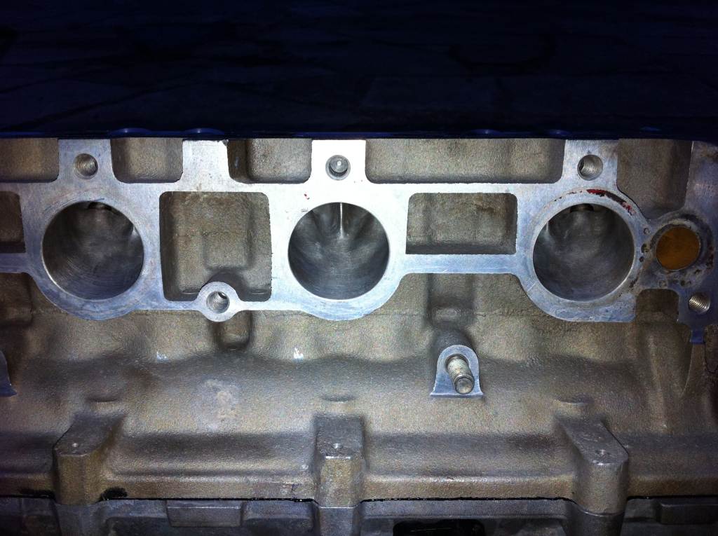

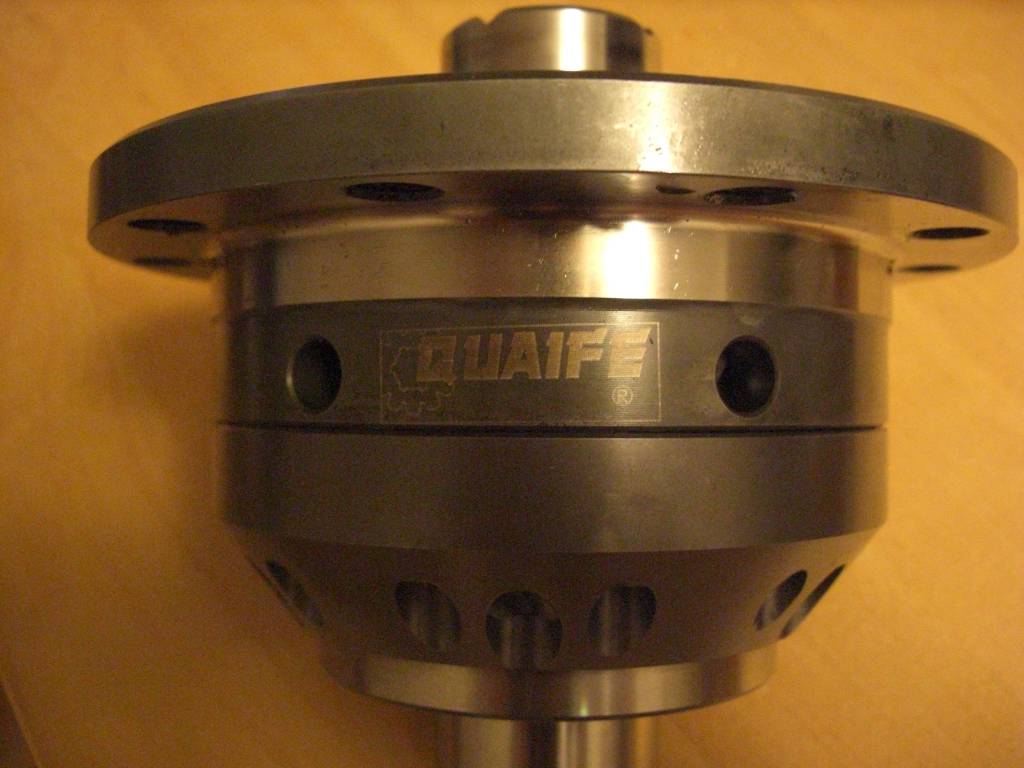

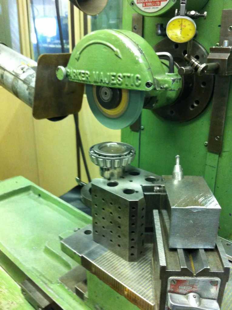

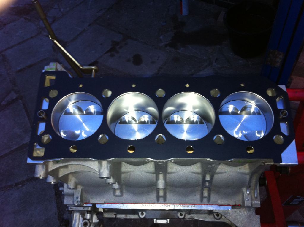

Fancy bearings for a fancy gearbox

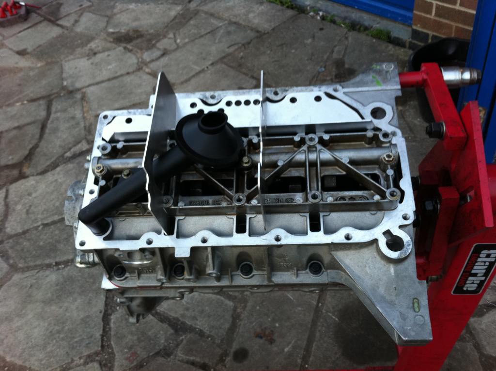

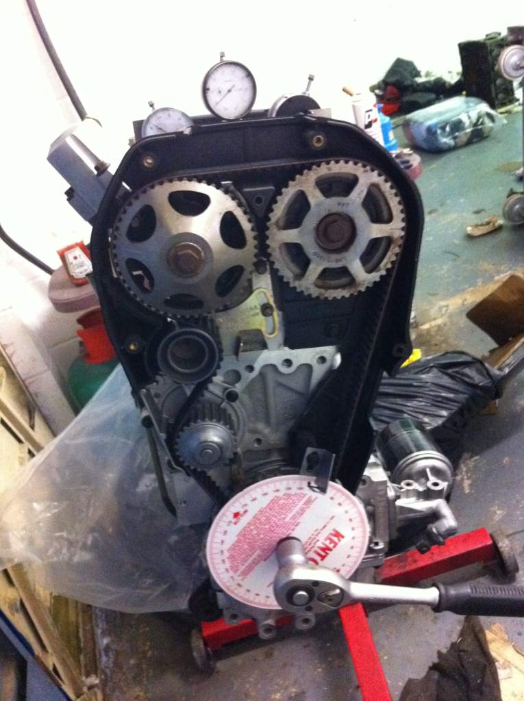

Dialled in cams including Piper BP270 exhaust cam

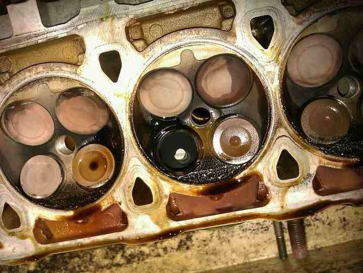

Drove home from work the other day with a strange metallic sound at low revs. After the engine died completely (before I got home), found the cam timing was out between the cambelt and VVC belt pulleys - roll pin had sheared and pulley slipped. Strangely the bolt was not loose.
Removed the head to find one valve without a head and 11 bent ones! Swapped the head (with some help from Matt Parker) for the spare I had and it's all back up and running again. Exhaust note is noiser and it feels quite a bit torquier, so I suspect it's been like this since I got it. I just assumed it was slow (compared to a Metro with a 160) because of the weight! Can't wait to see what it's like with 200bhp+

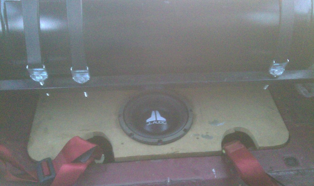

Uprated speakers for the doors - any suggestions for decent components to run off an amp? Was planning on getting some second hand JL XR's off ebay

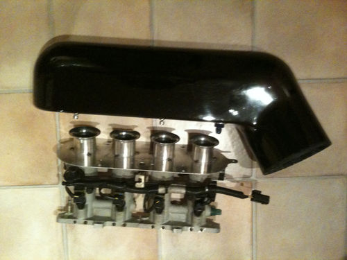

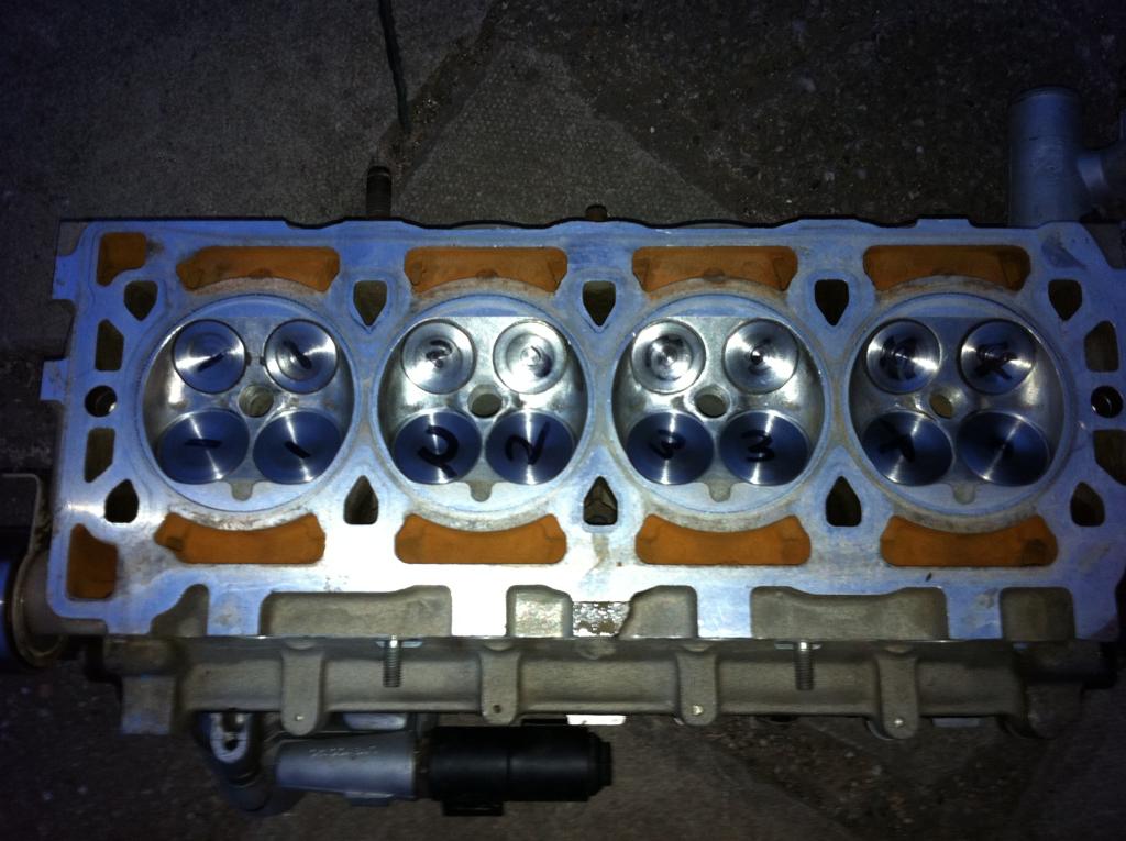

Prepare the new engine - bought some Titan DTH Throttle Bodies, so I need an airbox which fits (Pipercross looks like a strong contender), along with relieving the head where the cam lobes rotate, and of course fitting the lifters/springs/cams!
