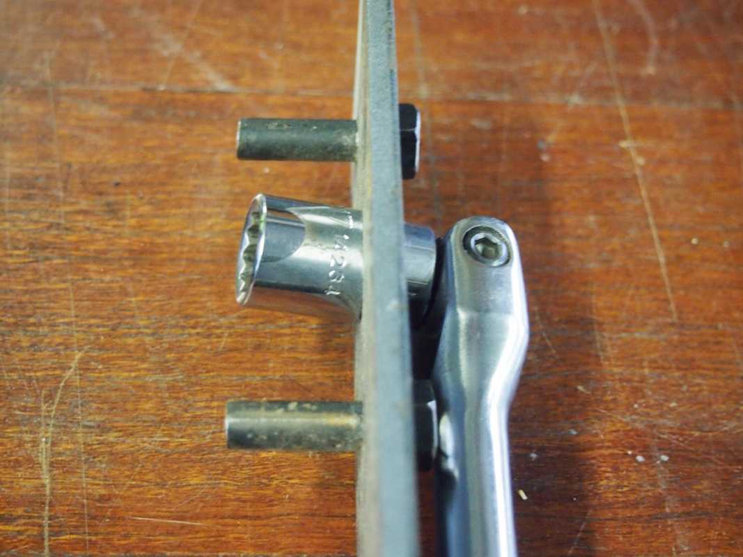

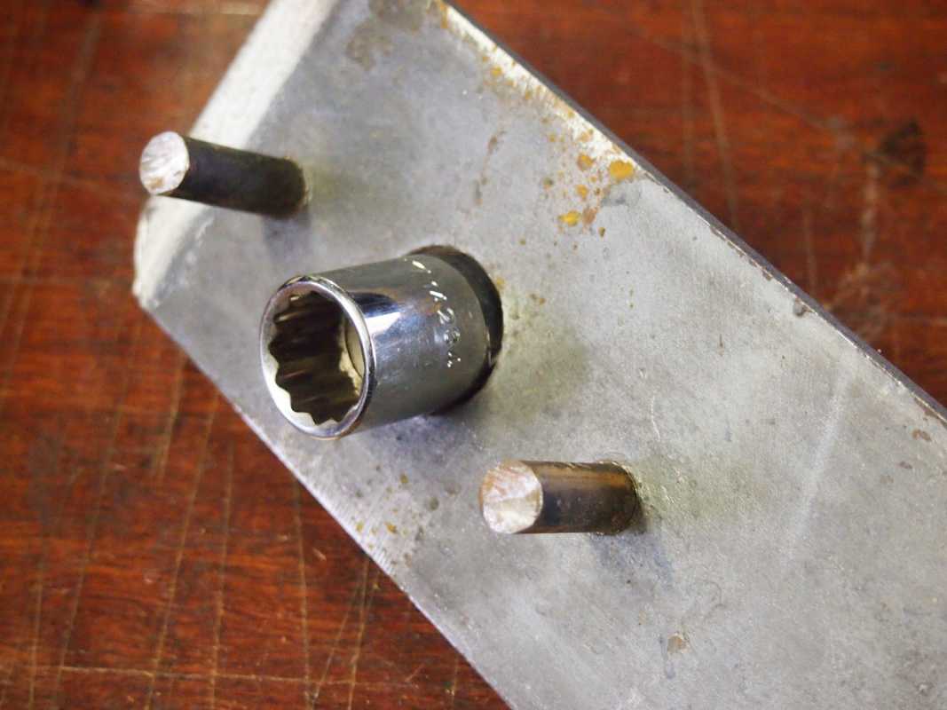

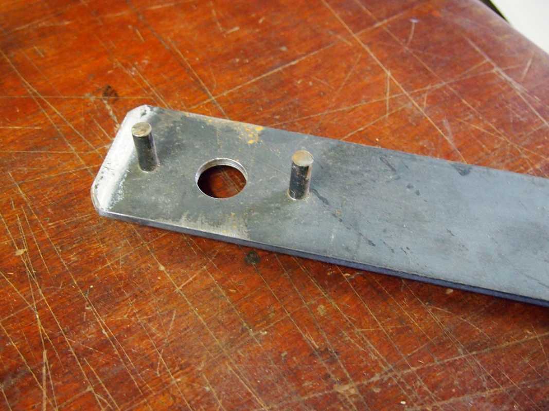

Another tool that I made and used on my MGF.
Badger probably knows what it is?
If my memory is right a 17mm socket is used.
Any ideas ???
[IMG]ht[/img]

Replied by Badger on topic Another Guess that tool.
Posted 11 years 11 months ago #147041
Yep a 17mm socket is used, I do know but lets see what others think.
Brian.

Replied by Raccoon on topic Another Guess that tool.
Posted 11 years 11 months ago #147046
hmm, it holds something in place that would turn with the bolt otherwise...
timing belt pulley?

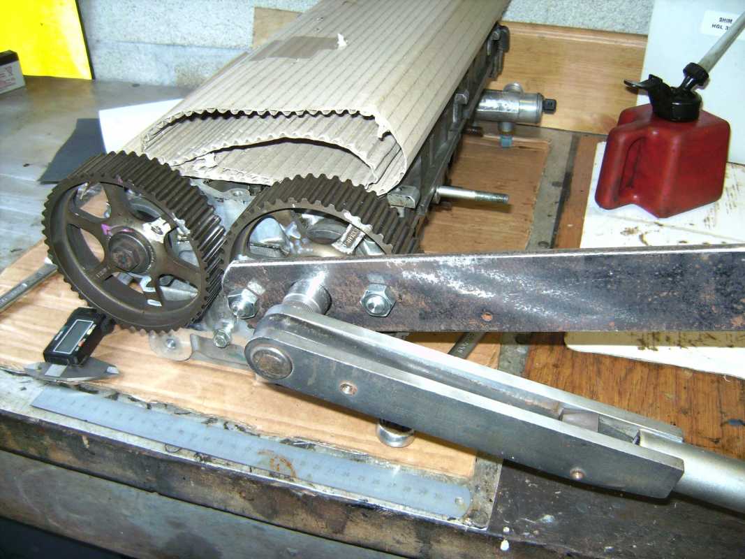

Davem wrote: Another tool that I made and used on my MGF.
Any ideas ???
Had to LOL when I saw your post as I had only made one a few days before earlier in preparation for doing my head gasket.
Image as below, just making sure it works before final assembly.
Brian.
