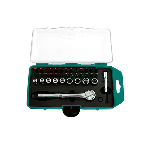

I have a 1/4" drive with a short socket set 5-13mm. Something like this:-

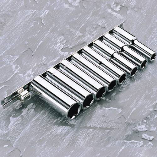

I also have a set of 1/4" long reach flat drive sockets
Specially designed 'Flat Drive' sockets allow up to 30% more torque to be applied, the socket grips the flats of the nut/bolt rather than the corners so will undo rounded nuts:-

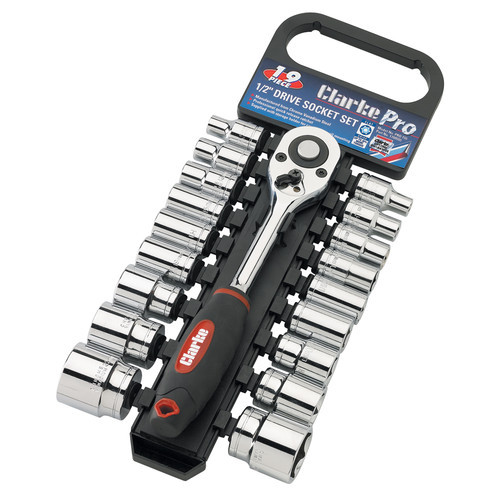

I have a 1/2" drive with a short socket set like this:-

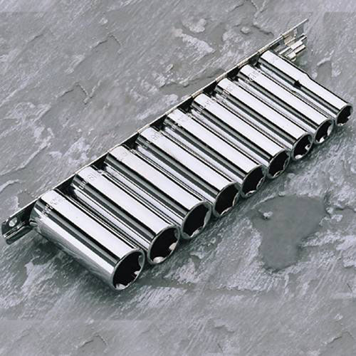

With a long reach flat drive set too.

These sets are all from Machine Mart but other suppliers are available. The 1/4" drive sets are very handy for small nuts and bolts such as the 11 bolts that hold the engine cover down.
The 1/2" set will cover most other areas of the car.
Some jobs, such as wheel bearing nuts can strain a 1/2" drive set. Breakages are possible.
A 3/4" set would be better, but expensive to buy for the limited use it would get.
It's worth getting decent quality sets, especially sets that have a breakage guarantee.

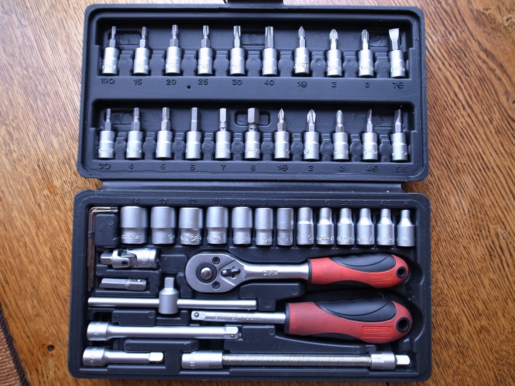

From the budget end of the market, I find this 1/4 inch socket & driver set very useful. It's 'Powerfix' and I think it was a Lidl special (but might have been from Aldi). It was about £12 and has sockets from 4 - 14 mm (including 4.5 & 5.5) and various driver bits for philips, pz, slot, allen & torx. The flexi extension is handy as is the mini UJ.
