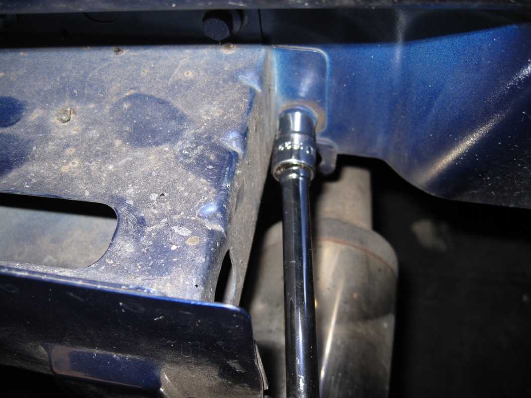

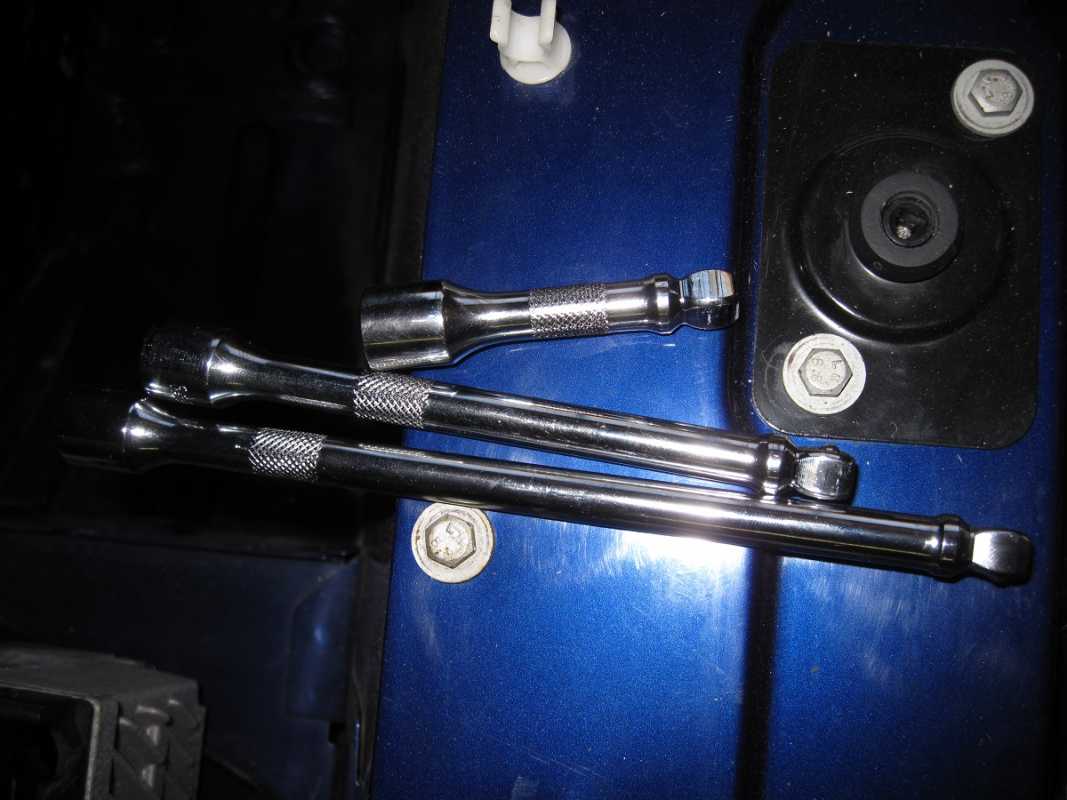

Got myself some wobble bars recently and find them great. They will allow a bit of sideways movement because of the rounded end. Useful in some situations for example -- When tightening or loosening the 4 nuts under the MGF inlet manifold the normal straight bar doesn't allow the socket to sit on the nut nice and tight slipping and rounding the nut off, but with these new wobble bars it all went a lot easier.

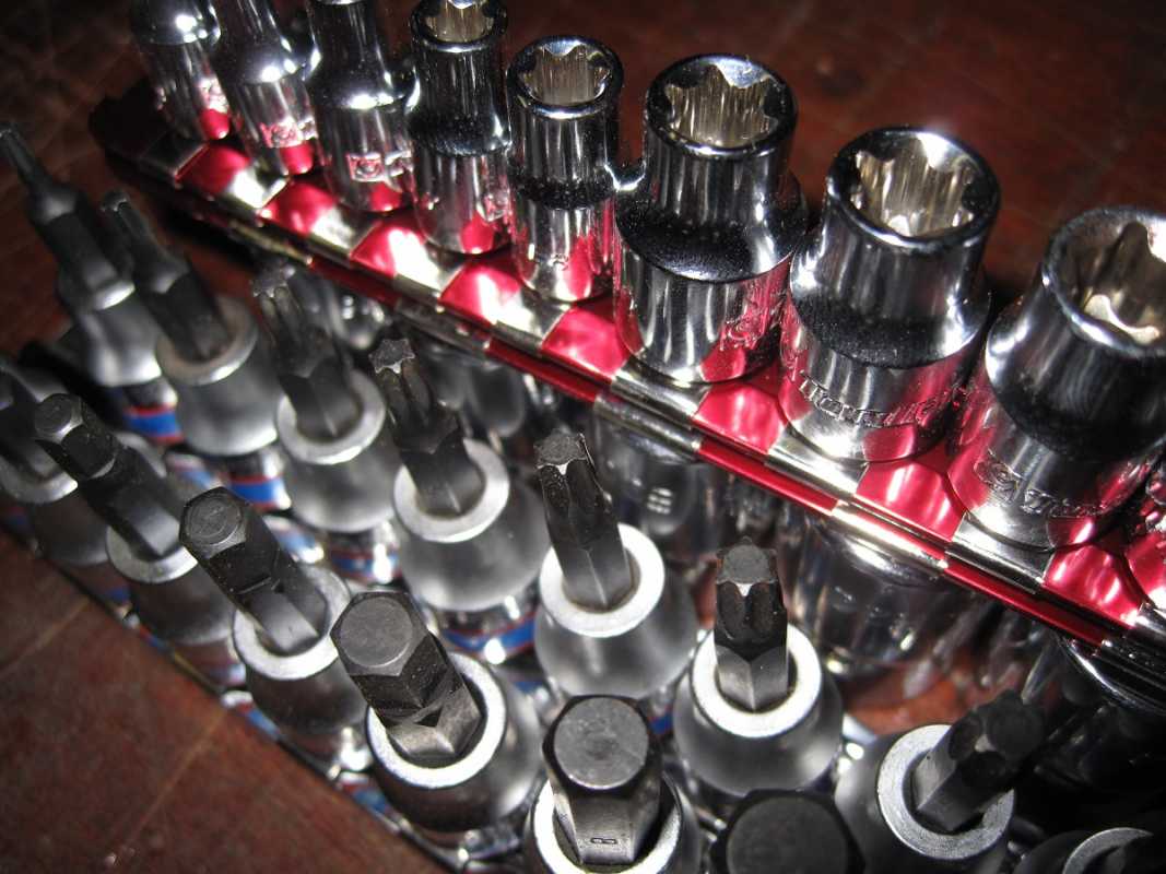

Allen key and Torx male and female are also available for use with sockets and of course very useful.
Edit The female torx are essential for
