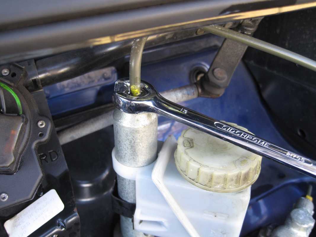

Dave for general use on flare nuts, the conventional six point flare nut spanner set like the Sidchrome set pictured are good enough for most applications that your likely to encounter I've made do with my two Sidchrome sets (1 metric & 1 SAE) for years before I lashed out and got the "crows feet" type about 4 yrs ago and of course the new toys I got last week.

Replied by Davem on topic Flare nut spanners/wrenches
Posted 12 years 8 months ago #133833
Did the clutch slave cylinder and the new flare spanners were perfect.
It was too dark at the slave cyl so I took the picture at the master cyl.
[IMG]ht[/img]
