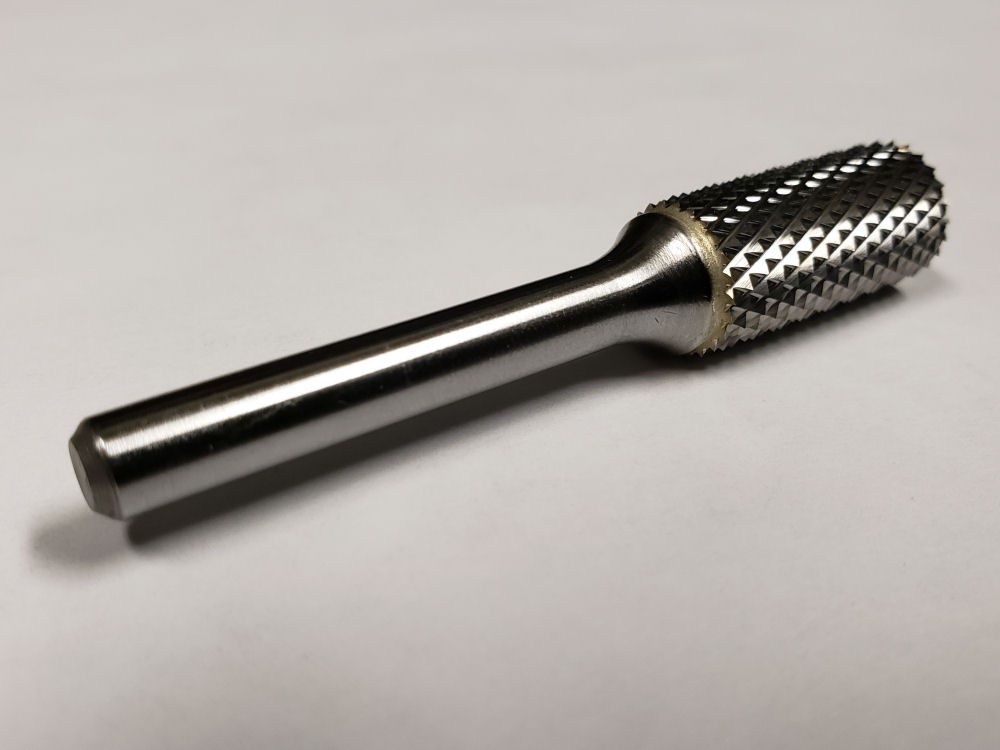

A good selection of burrs is required and good burrs aren't cheap. different burs are required for alloy than steel.
Alloy are what is known as single cut those for steel are double cut, what that means is the single cut cutting head has deeper but less cutting flutes, this is to prevent the softer alloy material from clogging up the burr.
Single cut for alloy
Double cut for steel

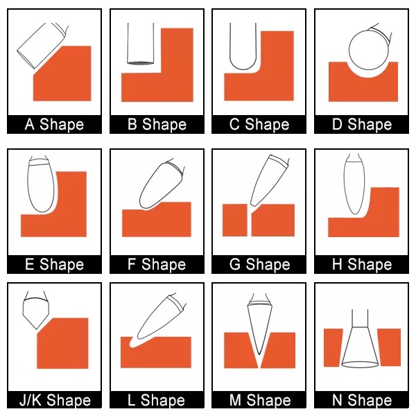

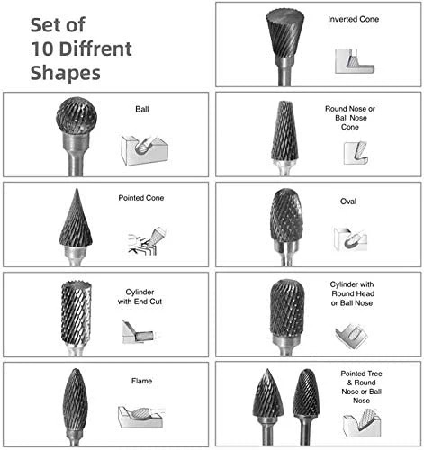

Some of the typical shapes and their uses
There are so many shapes it impossible to list them all
