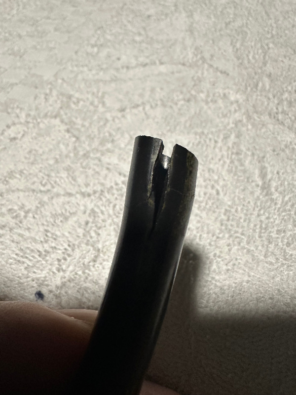

We took my ute to pick them up, the damned thing was running like a hairy goat, burning rich, when I got back I thought maybe the MAP sensor had shat itself so I rummaged though the spares and found another, went to fit it and found the vacuum hose to the sensor had gone as hard as a rock and split
Whacked a new bit of hose on......sorted!

Replied by Notanumber on topic If it wasn't for bad luck some blokes wouldn't have any luck!
Posted 11 months 1 week ago #217789
That easy fix on the hose must have been a welcome surprise.
Replied by Cobber on topic If it wasn't for bad luck some blokes wouldn't have any luck!
Posted 11 months 1 week ago #217790
Almost a disappointment..........NAH! who am I trying to kid!
