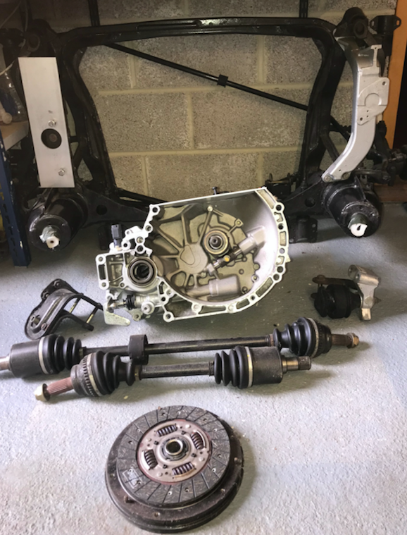

I do still have an MGTF rear-subframe complete, cleaned, painted and prepared ready for a motor and batteries/inverter/etc to be mounted, plus a suitable manual gearbox/half-shafts (just set in 3rd gear) and other bits if someone wants to make an offer - picture attached. It's a great project to do - I estimated my ROI at 5-years, so not too bad. Feel free to ask questions/advice.
