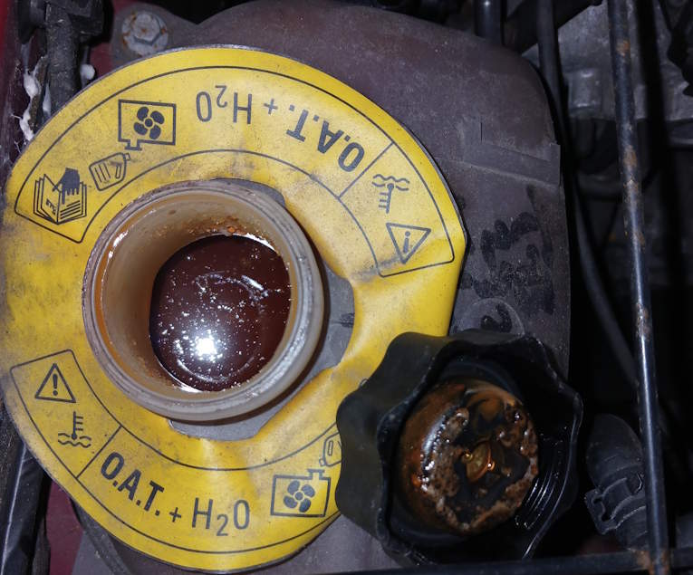

I noticed a wee bit of steam coming out of my exhausts today, when the engine was good and warm. With a sinking feeling, I lifted the boot lid, and saw that the header tank was totally opaque - normally (and I check it very regularly) it's very clean and clear, with a good level of the pink stuff. Now it's dark brown, and you can't see where the level is.
So I let her cool down, and took the cap off - there's a certain amount of gunge on the bottom of it too
Pretty sure it's the head gasket? The car's 25 years old, but only 25k on the clock - but there you are.
Would members agree with my diagnosis? Any way of knowing if I've warped the head etc, or caught it in time?
I'll have to book her in with somebody anyway - not the sort of job I could tackle.

Looking at your picture, it doesn't look promising!
There is no way of really diagnosing a warped head without removing it and putting a straight edge across it, you can use a compression test, a cylinder leak down test, a sniff test or a coolant system pressure test to diagnose a failed head gasket, and they can indicate other possible combustion chamber problems such as a cracked or warped head, a unseated, cracked or porous cylinder liner, but the only way to know how bad the problem is, will require removing the head to be sure.

Thanks everybody. Yes just trying to track a specialist down here in NI is the problem - we did have an excellent guy who was a magician with all things MGR, but he lost interest a couple of years ago and just packed the whole thing in. Sadly he can't recommend anybody else either, so it may be a struggle. I have one lead to follow up - will post any updates here.
The guy is about 15 miles away - I'm assuming it wouldn't be a great plan to drive the car to him
