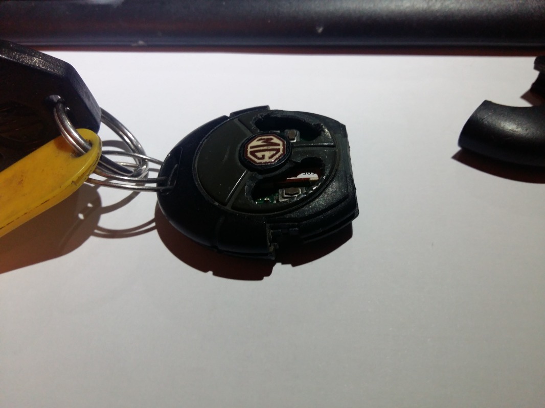

First of all ,Merry Christmas to all on the forum My internet has been off ,since 28th November due to the "wonderful "service of talktalk .More later .Ive nearly finished the restoration of my TF and Ive been staring it every week or so ,however when I tried a few days ago all I got when I turned the key to start ,was a continuous two tone sound .This happened two or three times then it started .It  has done this a couple of times so far.Any help please .There are no warning lights on the dash.

As a wild guess, is it the fob bot talking to the security unit? I think there is a detector coil near the ignition lock switch that is sensing a signal from the fob.
No signal gives a ee-orr sound.
Maybe changing the fob battery as a first shot?

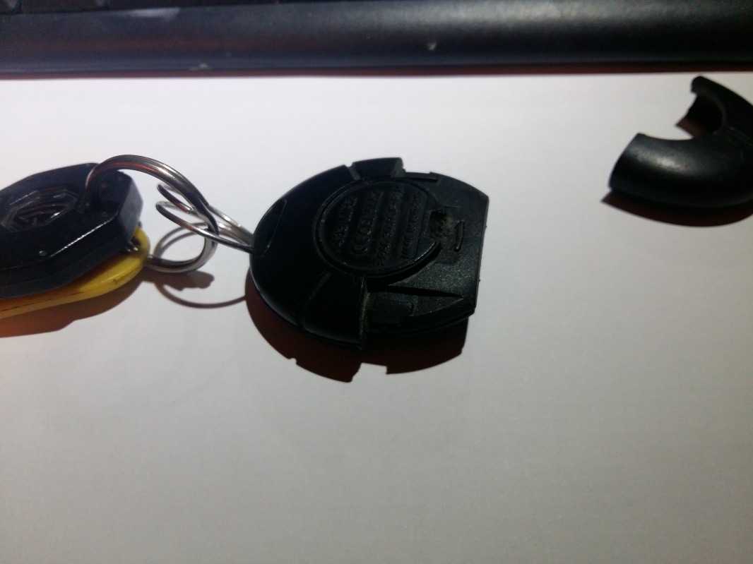

Morning ,its taken me 25 years to get my spraying acceptable So Im a bit reluctant now to stop .But my wife insists health and age is against me .I`m having a few side  effects from the prostate cancer  which aren`t pleasant ,but as long as I have a project that`s fine .I need to replace the battery in my key fob .Ive separated the case ,what next Len    ,

Ive sorted the fob out,didnt look close enough Happy Christmas Len

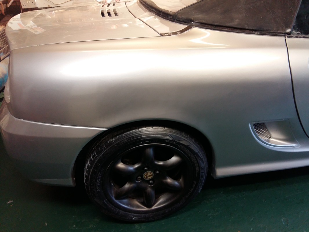

I thought I`d finishes spraying ,but found a blemish on the rear O/S wing I tried to blend some spray in but it wasn`t to be .Silver is the hardest colour to match ,if your spraying the sides of a car ,each panel individually , you`re lucky if they match . So Ive dont the complete wing .At least it found me something to do .In the new year when Ive sat and digested all the turkey   ,I have to flat with wing with 2000 wet and dry ,the cut the whole car with a polishing mop and Farecla So still a bit to do All the best to all the forum Len

I dunno Len, my car is Volcano orange metallic  with a dash of flip, I suspect silver would be a doddle to paint match in comparison
