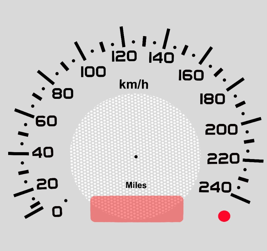

My Australian MG F has a Speedo in Miles, although the Odometer is in Miles that is no problem, what is a problem is that the Speed reads Miles / Hour.
The Speedo does have a Kilometre scale as well but it is smaller and not that easy to read. I am restoring the MG F for my grandson who is about to get his license and the small Kilometre scale would not be a wise choice.
Using a photo of a Kilometre Speedo (poor quality) I used it as a template and created in Photoshop a Kilometre Dial.
I created 2, one with Miles as the odometer label and one with no label.
The Dial needs to be printed with a width of 11cm.
I then treated the printout by spraying a coat of "clearcoat"
To punch the holes I used a couple of hole punches plus for the small holes (included rounded edges of the odometer slot) I used the blunt end of a drill bit which I ground flat.
Warning
When inserting the Needle back into the speedo care is needed to ensure that the needle goes into the correct position (into the plastic hole)
I accidently inserted the needle to one side which damaged the wire coils. If not confident inserting the needle then the alternative is not to remove the needle but put a slit in the bottom of the new dial
and go around the needle.
Before I removed the Needle I lifted the Needle over the stop pin and let it come to rest approx. 1cm passed the stop. This is the position I put the Needle back on after.
I removed the Speedo needle by carefully lifting it from under the centre of the Needle
Before glueing onto the Speedo, I marked the outside of the old Dial the 0 , 60 and 100km/h marks. You then use these marks to line up the new Dial.
Before reinstalling the Speedo cluster I am going to test the speed using a GPS reading (Google Maps), I am limited to where I can drive the car at the moment as the car is unregistered.
I hope this helps someone.

Replied by TA22GT on topic Replacing Speedo Dial from Miles to Kilometres - Printable
Posted 1 year 8 months ago #209273
That looks great! Very professional.
Replied by Delbourt on topic Replacing Speedo Dial from Miles to Kilometres - Printable
Posted 1 year 8 months ago #209327
As a matter of interest how difficult was it to remove the Perspex front cover from the cluster?
I ask as I would like to replace mine
by Delbourt
Replied by SteeleGC on topic Replacing Speedo Dial from Miles to Kilometres - Printable
Posted 1 year 8 months ago #209338
It is very easy there are 4 tabs that need to be carefully pushed in slightly.
The Perspex and a black surround comes off. I don't think you can split it any further
