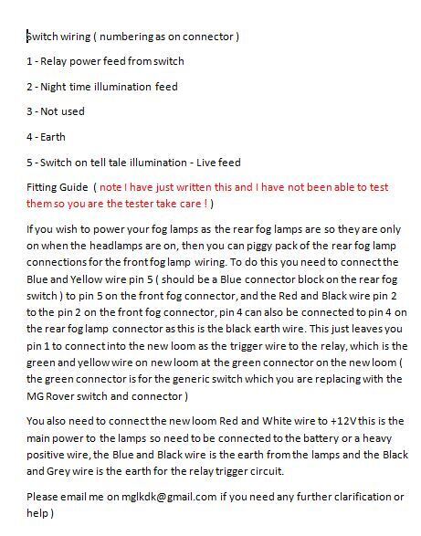

Hi yes I totally agree - hence why I still genuinely have no real clue what wires to attach where. I think I will add the coloured wires to the back of the switch connector in order shown in the picture/diagram I attached before, but I then don't know on which cables to then piggy back/connect them to?
I went back to the seller who was able to send me the following to 'help' me? Can anyone make sense of it with regard to what I currently have in the car? Thanks ever so much as always!!

Anyhoo I am not sure my last post had the pic attached - so here are the so called 'instructions' that the seller has sent to me...
