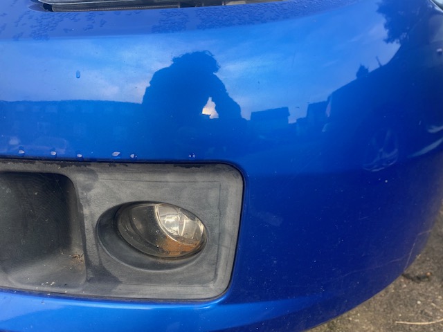

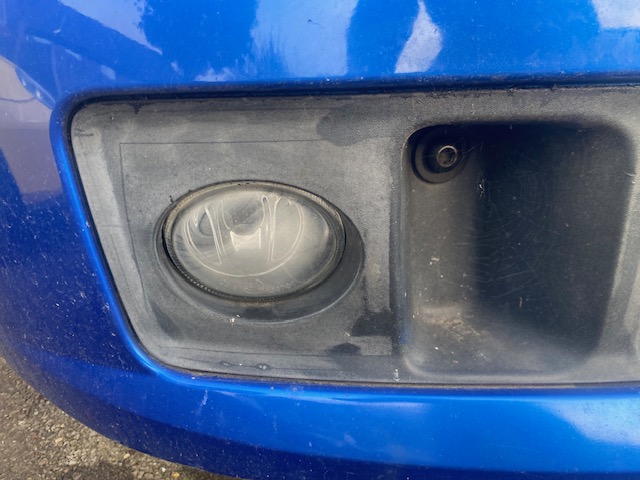

Hi guys - here is a picture of the front fogs/spots.... they were always an optional extra on these cars were they not!

Replied by TA22GT on topic Adding Spotlights to MGTF - wiring help needed pretty please!
Posted 1 year 8 months ago #209181
Yes those are foglights.
It's about the only extra my car came with!
