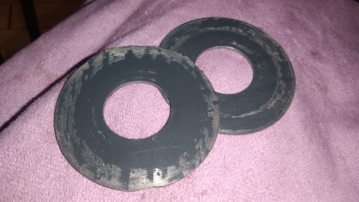

That certainly looks like a solution to the compliance problem on a TF. The only comment I would make would be the material he used to make the doughnut didn't look like a "permanent" fix.
I would probably use a harder plastic material rather than rubber. As I did when I fixed my compliance bush issue with the F.
2mm thick ABS plastic.
I fitted these over 10 years ago and they are still in A1 condition. They are 60-61mm outside diameter;25mm internal diameter. I used a number of them as shims to take up the worn space on the compliance bush, which is the issue on the F.

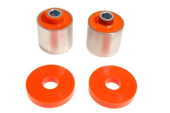

I see that the TF polybush kit uses a separate poly doughnut

Made some stainless rings with HDPE shims to get the play out.

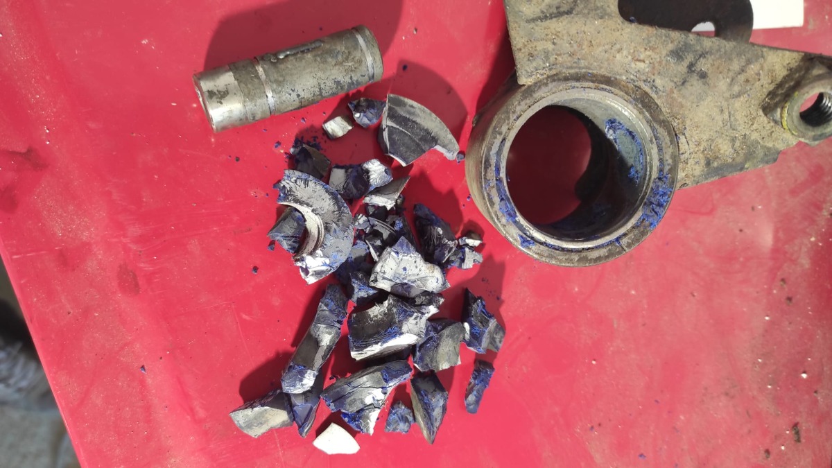

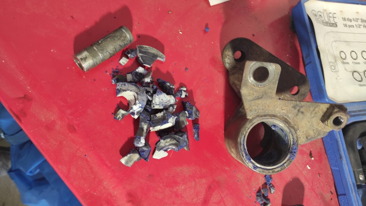

    I changed mine to poly bushes roughly at the end of 2013 or beginning of 2014. No problem with the old ones, just an upgrade.
Now I wish I hadn't. They literally disintegrated. I have just changed them again. They had actually disintegrated at least a couple of years ago but I very rarely use the car so it wasn´t something I needed to do.
The same happened to the ARB bushes and ARB droplink bushes. I have replaced the links with the ball joint type and the ARB have gone back to rubber - interestingly the VW part 6Q0411314 is compatible with the rear ARB bushes so I have fitted those (as they are very available without silly postage and import duties - thanks Brexit..)

That bush is fairly fornicated, it must have been a very hard grade of poly to do that! Not all poly bushes are equal some are much harder than others.
