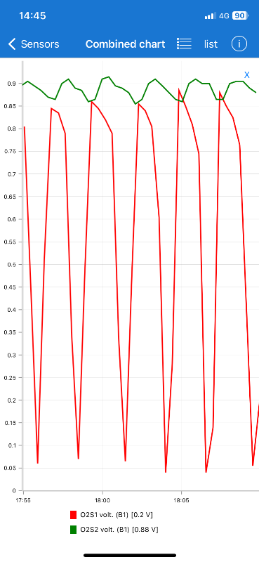

see the attached live data from last journey with MIL lit.
Your thoughts on the way to resolve this issue would be greatly appreciated.

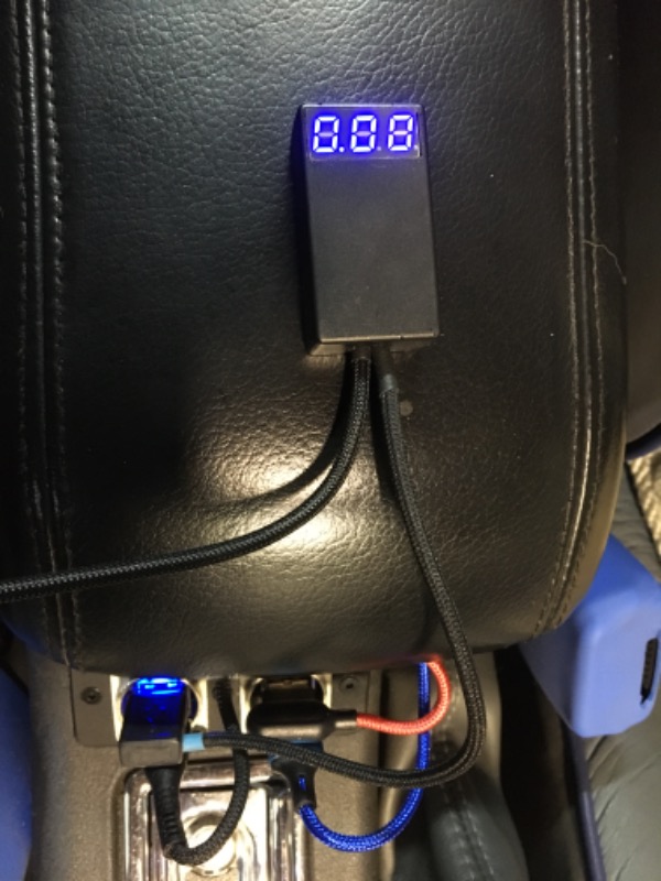

I did some work a while ago on a design to monitor the stoich point (optimum point) for maximum efficiency. I’ll include a picture of a device I made to connect to a breakout point beneath the arm test, this is a very sensitive volt meter & NO I won’t make you one! It isn’t just a black box with a volt meter in it, it a black box with an instrument amplifier & a volt meter.
The values from different sensors was interesting but only the Bosch sensors were consistent. I would rather use a second hand Bosch than a new pattern part.

Interesting that the site you linked to in its explanation of O2 sensor operation stated that the post cat sensor should be some reasonably stable value. Other sources state that it should oscillate as per the pre cat. My confusion continues having seen both types of traces from the post cat - the one above recently and the oscillation when it was freshly replaced.
Anyway I’ve just had a 40 odd mile blast and there was no sign of the MIL. I’ve also made a note of the mileage it came on at the other day, so I’ll see if what the mileage difference is if it returns. Some sources have mentioned around 100 miles and/or a few start stop cycles between the MIL showing itself. All in all it working perfectly so I can’t see what the problem is (famous last words….).
