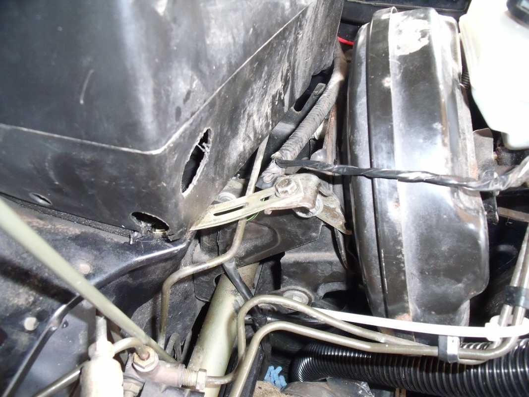

Replied by David Aiketgate on topic Clutch problems
Posted 1 year 7 months ago #210143
This is my first attempt.  .
While not aesthetically pleasing, it did the job and firmed up the brake 'feel'.
The job was complicated by having the old type heater box. In retrospect, I should have cut it out and fitted the newer snorkel type.
Last Edit:1 year 7 months ago by David Aiketgate
Last edit: 1 year 7 months ago by David Aiketgate.

Replied by Notanumber on topic Clutch problems
Posted 1 year 6 months ago #210173
That photo brought back memories of fitting my brake master cylinder brace. It was quite a struggle to get the full set of bolts in as a result of many years of braking on the bulkhead but it was well worth it for stiffening up the brake pedal and preventing any further flexing of the bulkhead.
For stiffening up the clutch slave cylinder , does it need a different brace depending on whether its a pre or post PRT car ?
Replied by Laurence J on topic Clutch problems
Posted 1 year 6 months ago #210175
My understanding is that it’s a clearance issue between the brace and coolant hoses on the PRT equipped cars.
